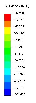

Regarding the principal stress, I know I can plot each of them, but the stress value for each one is start at -X (MPa) and ends in +Y (MPa)
I made an example:
The values of the P2 stress plot is changing from min. -304.636 to max. 237.998.
Should I use the absolute (|-304.636|=304.636) value of the min. which is larger than the actual max. value?
For failure criterion you should use absolute value (304.636 MPa in this case).

That is not correct. Using the maximum absolute value of each principal stress component from any location in the model makes no sense. The strain limit is local. 5.3.3.1 requires the local strain limit be met at each point in the component. You need to calculate the limit as a function of S1,S2,S3 and Seq at every point in the model and compare it to the local plastic strain. There is only one value of each principal stress at each location and only one value of the equivalent stress at each location. The principal stresses have a sign, which should be kept when evaluating the triaxiality factor. Do not use the absolute value. This will not correctly predict the local ductility.

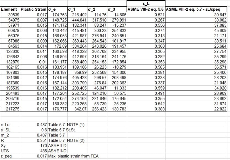

What I have done so far is to create this table from the FEA results:
But, I don't know if it's enough.
The ratio of plastic strain / local strain limit is greater than 1 for each element I checked...
I don't use Solidworks, so I can't advise you on the software. For mesh settings, your stresses and strains should be converged to make the results meaningful. I'm not sure what to say beyond that. Regarding your table, you are calculating local strain limit / plastic strain, rather than plastic strain / local strain limit. The limits you calculated are all greater than the plastic strains you calculated. This would be acceptable, so long as your math is right, your model is right, and there is no forming strain to account for as in Eq. 5.7.
