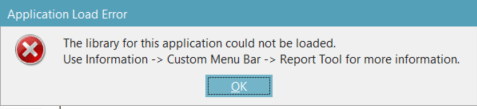

NX Application Load Error
gomallen
Automotive
Mar 11, 2020
1
This error below keeps popping up anytime I open or create a drawing. I'm running NX 11.0.2.7. Anyone have any ideas?
Thanks!
There is a custom button on one of your toolbars(maybe created by your CAD Coordinator?)which tries to open a dll in your session.
NX is not able to open this dll. It either can't find it or it is not signed for your NX version. If you follow the instruction in your error message you can find out which dll is causing the problem.
