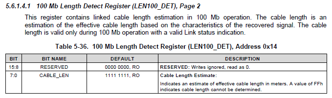

So far it looks like it is up to the PHY, as indicated by this TI DB83640 datasheet:
There must be some underlying IEEE 802.3 magic in there somewhere...

I finally found a non-TDR example for length estimation. Texas Instruments 'AN-1508 DP83849 Cable Diagnostics' (snla085a.pdf) gives on oversight of how a 100Mb link calculates cable length:
100MB cable length is a linear function of the Analog (AEQ) and Digital (DEQ) equalization coefficient
values in the linked state.
if (AEQ == 0) Length = (A1 × DEQ) + B1
if (AEQ == 1) Length = (A2 × DEQ) + B2
and so on ...
The algorithm for computing the electrical cable length is depicted above. The constants {A1, A2, ... } &
{B1, B2, ... } are determined by statistical study of various typical case cables. The computation is
completely handled in hardware. The resultant cable length is available using a simple register read.
With the caveat that this is only good for about +-10m accuracy.
