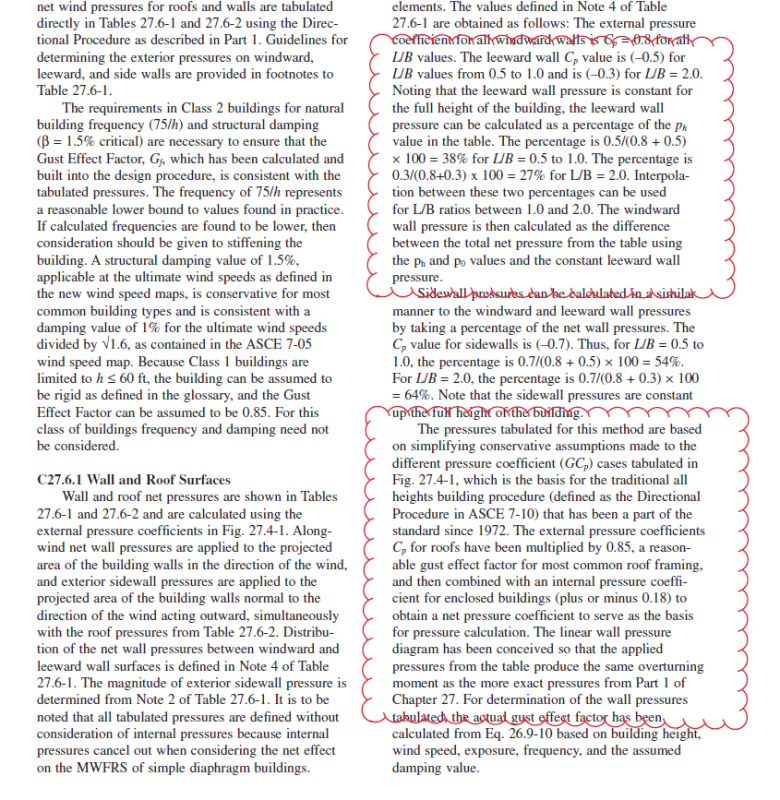

It's a bit of a weird quirk of wind loading in the ASCE (which is the basis of the IBC). Actually, there is some explanation given in the ASCE 7-10 commentary (C27.6.1).
Unlike the windward external pressure coefficient, the leeward pressure coefficient is allowed to be reduced based on the building height aspect ratio. As the building becomes taller, the leeward coefficient is allowed to be reduced to a minimum of -0.3. The idea is that, if the aspect ratio is very small, the leeward pressures become strongly correlated so you have to use a larger leeward coefficient of up to -0.5.
It seems like the reason why it is set linear/constant with height is for conservatism and it's also done so that you get similar base overturning moments as if you had used the structural loading approach.
