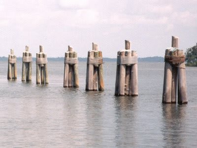

For barge traffic, dolphins (see photo), traditionally constructed with driven timber piling and used along with timber fenders frequently protect bridge piers from impact. This 376 page publication prepared for the US Navy, "Analysis and Design of Dolphins" likely will include info on ship/barge collisions. (I have not read thru the document to determine that).
Dolphins have a number of uses, protection of piers is just one.
