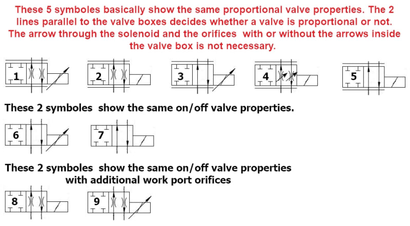

Picture a proportional valve 4 port 2 position (infinite position, spring return, electrically actuated)
Normally closed position = all 4 ports are blocked with a "T" in each position
Open position = shows two arrows one pointing in one direction (straight up) and the other pointing the opposite way, (straight down)
In addition to the arrows there are flow restriction symbols ")(" that straddle each of the two arrows.
I think I have identified this as a proportional throttle valve with chokes inline with the flow paths.
The question i have is this. Since the arrows only point in one direction does this make this flow only one way? Or is it possible to reverse the flow through that valve?
This is basically being used as a buffer system for an oscillatory device so there is no pump or tank.

The arrows pointing in opposite directions are part of the standard symbol - just making it easier to understand what's going on when you look at a three-position valve.
We use plenty of them with flow ignoring the arrows.

Note that the arrow along the line indicates a press compensated proportional valve. That would mean at each setting it will maintain 'about" the same flow regradless of delta P. Note that putting a manual flow control downstream (say for stabalizing back pressure) of a press compensated valve does not do much good. The press compensated valve will dominate the flow.
this may help you:
if too small, please see my attachment.
R.Efendy
