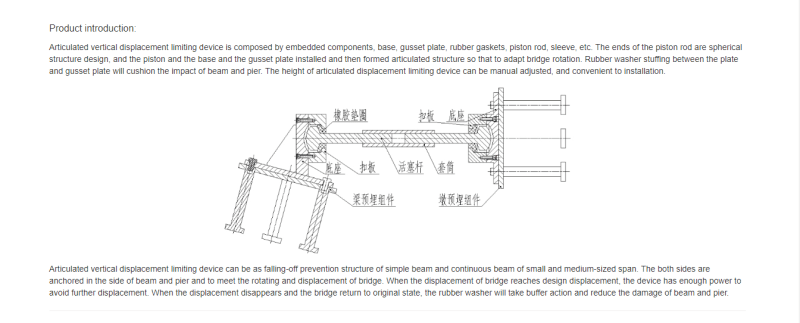

I was working on a bridge repair project and I happened to encounter this so-called "bridge anti-falling device" item along with the scope of works. Can anyone help me with how this works or what are the components of this? My initial assessment is that this was only a post-tensioned cable.

Note the square box on one side of the "tie to beam", and the bullet on the other side, the two pieces could for a closed cylinder. Also, the slightly bend rod (on the far side), indicating compression.
Bridge deck falling-off Prevention Device during seismic event. This could be steel cable or articulated steel rod with piston. I found the picture below at web...
I can say with 95% certainty that those are seismic cable restrainers. Our office has designed about a dozen of these for various bridges around my state.

I am not 100% certain what the bulbous caps on the end are, but my guess is that they are either grease caps or anti-tampering caps. The ones that we have designed use a bearing nut and a jamb nut. The bearing nut is not fit snug to the face of the beam since we need to allow for a small amount of serviceable movement for every-day use. For seismic events, where the movement is higher, the nut will engage.
