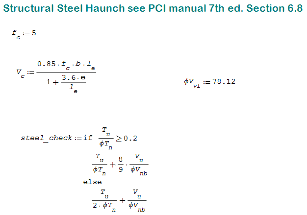

I looked at SMath but the output looks very "spread-sheety"
I have attached a simple calc sheet that has the look I like.

@Haydenwse Not sure what you mean; Smath's raison d'etre is to duplicate Mathcad's WYSIWYG interface, and I think I can duplicate everything in the snippet you show. I try to post something tonight

I was able to make an SMath file that looked pretty close to what you showed.
SMath because it's free and WYSIWYG

IRstuff, I have not seen any printouts from Smath as was basing my assumption on the screen shots that they have on their web page. This was all that I saw and it is pretty clunky and hard to read. Does it allow for Boolean functions to find controlling limit states?

Haydenwse: "IRstuff, I have not seen any printouts from Smath as was basing my assumption on the screen shots that they have on their web page."
Bad example... I'll try coding your stuff using the format I usually use. Forgot to thank you for the added info...

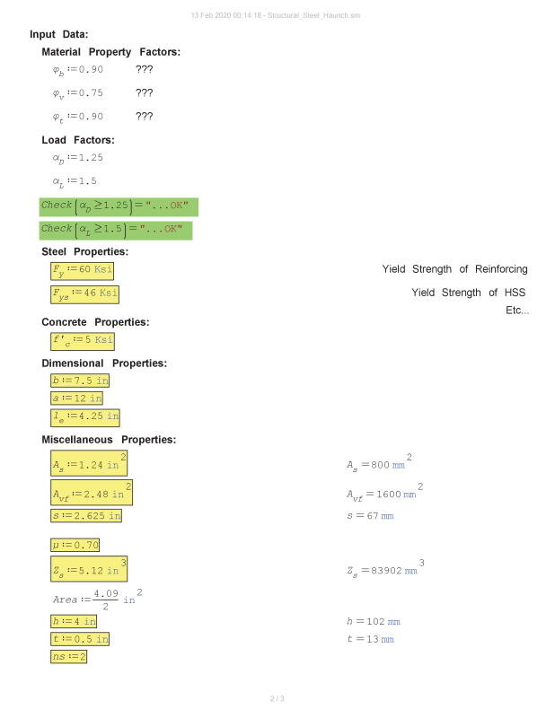

This is the way I usually write SMath programs. There's an error and I couldn't find the formulae in the posted sheets. Data seems to be right but different numbers.
Dik
Didn't try to duplicate everything, and admittedly, the math font is pretty lame, and there's no fix for that yet.
By the way, I noticed you're not using units. Any particular reason for that? That's THE REASON Mathcad is so useful, since it seamlessly deals with units.
