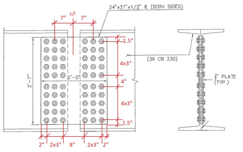

Below is a sketch of the connection:
The plate does see in-plane moment due to the eccentric location of the shear load, but with a gap at the flanges will the connection transmit moment from the beam? or would it allow the beam to rotate instead (connection acts a hinge)?

There will be moment due to bending of the girder and from the eccentricity of the shear. The eccentricity is the distance from the center of the splice to the center of the bolt group. The total force on a bolt (and bearing on the edge of the bolt hole) is the sum of the vertical load from shear and the force due to the moments, both the applied moment in the girder and the moment due to eccentricity.
There is a limit amount of moment to maintain conformance of displacement between two linked segments, but it is conventionally assumed pinned/hinged for analysis and design, except for the design of the link elements (plates and bolts).

It's also not a pinned connection, retired13. Modeling the girder with a pinned/hinged connection is the conservative approach for the girder, but certainly not for the connection, which is very likely to be the controlling feature for the load rating.
I also agree with STrctPono's approach of modeling it in AASHTOware (BRASS-Girder) with a short section (as short as it will let you) that is just the splice plates as the 'girder section'. With that you will get moments, shears and ratings for whatever live load combinations you input.
After that, you'll need to check the splice components (bolts, bearing at the bolt holes in the splice plates and web, net section fracture of the splice plates, net section fracture of the web) for the moment, shear, and moment due to the eccentricity of the shear. You should be able to use BRASS-Splice to verify your checks by entering tiny flange areas. If you need some help with that, let me know what version of Splice you're using, and I can probably help you. Versions 5.0 and up are using the new design method in the 8th Ed. of the LRFD spec, which is radically different than the previous method. I was deeply involved in the development and beta testing of the older versions of Splice, but I was not really involved with the update to Version 5.0 and beyond.

I guess I never tried one without flanges. It's very possible the calculated web portion of the design moment, per the equations in the spec, would not be the full moment on the girder. Since the spec. equations, and therefore the programmed equations, don't consider a configuration without flange splices, you may not be able to use the program.
If your sketch is to scale, bearing at the web holes (bolts tearing out of the web) could be a controlling failure mode once you apply the moments to the connection. Calculating the polar moment of inertia of each bolt group (the bolts on each side of the splice) will be a PITB with the variation in spacing. The program wouldn't have given correct answers because of that, either, since it only handles regular 3"x3" or 4"x4" bolt spacing.

The splice is definitely not a design error - that's so called Gerber beam, and the splice is located at or near zero DL moment. Design assumption was that only shear will be carried, with the connection plates forming a plastic hinge.
You can always just check all the failure modes by hand. You are already getting a moment in the connection due to the shear coupled with the eccentric bolt arrangement so it's pretty straightforward to add the additional moment you get from the beam analysis.
