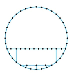

If you do want to use FEM, you can try the 1D Elements program linked below. There is an an example file called "fuselage frame" as well (corresponding to the picture). For arbitrary shapes, you can use the NodeMaker program and just pick the nodes on the screen. You could also compare the results to classical solutions.
