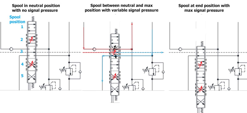

The VFO system has the same schematic layout as the CPU system,
BUT

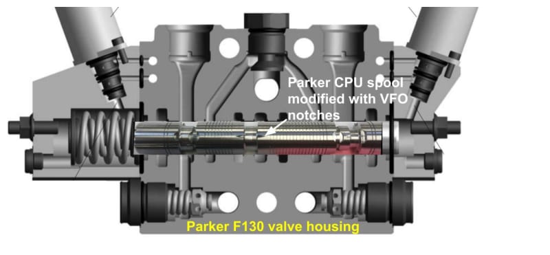

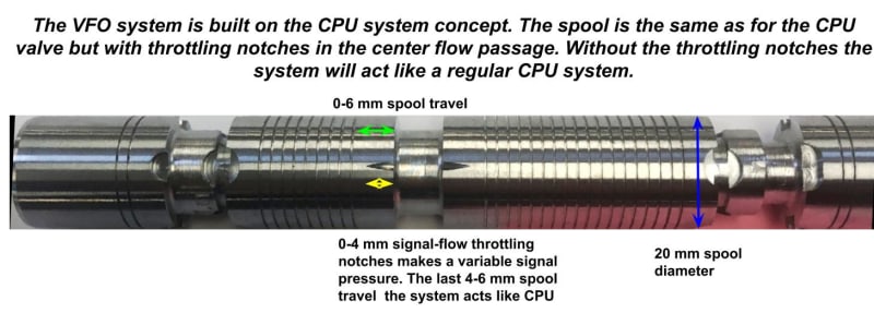

the VFO system has a special spool that allows throttling the signal flow that comes through the control orifice upstream of the control valve. According to an engineer at Parker office in Elk Groove Illinois, Jarmo H, the spool has special fine deep notches that throttle the signal-flow throughout the spool movement. That gives a variable signal pressure back to the pump compensator proportional to the spool position.
It is actually very simple since the can use the standard CPU directional valve pack and the same CPU spools that are just modified with this special notch.
The standard CPU system spool directly cut the entire signal control flow when spools initially move from the neutral position while. The modified VFO spool doesn't cut the entire signal flow until the spool reaches the end of its full stroke. At the end position the signal pressure is maxed out and so will the pump pressure be.
Just now the control orifice is a variable needle valve in the lab environment since the system hasn't been sold out on the market yet.
The original CPU orifice has a diameter of 0.7 mmm, this VFO system requires a slightly bigger signal flow to bet "throttable", so it's more equal to 1.0 mm diameter and that will make the control flow 1-4 l/min.
In this image, I have photoshopped the spool into the valve housing to show the proportions of the special notches

The VFO system isn't a "Load-Sensing" system, it is more a "Spool Position Sensing" system.
I understand your comments about the definition of Open Center systems versus closed center systems.
Regular Load Sensing systems with pressure compensated variable pump usually doesn't have any flow leaking to the tank (I am talking about Parkers LS system with load signal copying valves in the spools).
A CPU system always has a control flow via an control orifice through an open center in the directional valve. The difference between a Constant Pressure Unloaded Open Center, CPU OC, system and a regular Constant Flow Open Center, CF OC, system is that the CPU system closes the center at the beginning of the spool stroke, and the CF fully closes the center at the end of the spool stroke.
A regular CP system doesn't have any control flow through the center and then is a fully Closed center system.
I know this is confusing and the industry mixes this up a lot. But it is pretty well understood in the mobile hydraulic industry.
The reason Parker has developed this VFO system is the take the efficiency pros from the variable flow CPU system and combine it with the "feel" pros from the CF system for the backhoe and excavator market. The excavator tradition is used to have a CF hydraulic system that lets the operator "feel" when the bucket hits resistance in the ground (like a sewer or a cable) by slowing down the motion. With a modern CPU or LS system, they don't get that same "feel".
With this VFO system, they will get that feeling, or at least something close to it.

Here is another schematic showing the five different VFO spool positions
