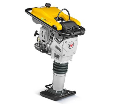

Just a question about compaction on top of culvert. After completion of a precast box culvert, how is the soil on top of the box culvert going to be compacted? If the vibrating roller is too heavy, the compactive force may break the top slab if the soil layer is too thin.
Is there a formula to calculate the force or pressure exerted on top of the culvert given the layer of backfill on top of the culvert changes? I can think the easy way is to assume the roller exert a line load and is distributed 45 deg down the depth of the soil.
Any helper?

What I mean is the compaction of the back fill to the top of culvert. It happen that the culvert is directly under a road 1.8m below for 150mm in length. Structurally the culvert is designed for 1.8m backill and driveway traffic load. But during backfill, the builder may use a heavy roller for a quick job. To avoid damaging the culvert, what is compactor to be used initially to prevent the damage? The compactor is dynamically adding extra force onto the culvert

The diesel powered Ramex P/33 Trench Compactor is hand-operated and used in trenches and difficult access areas.  These walk-behind and remote controlled compactors weigh about 3000 lbs and were developed for compacting backfill in pipeline trenches more than 27 inches wide  They typically exert between 10 and 18 psi contact pressures at frequencies around 62 cycles per second (Hz), necessitating lift thicknesses of no more than 4 or 5 inches.
Pogo Sticks”  Hand-operated tampers, like this Wacker BS 700, typically exert compaction contact pressures between 7 and 18 psi  Tampers are only useful for compacting soils in lifts 2 to 3 inches thick at near-optimum moisture content, if trying to achieve 90% of the ASTM D 1557 compaction standard
Vibratory Plate Compactors  Above left - This Wacker VP1340A Plate Compactor only weighs 170 lbs, but only exerts a dynamic contact force of 5 to 7 psi, using 63 Hz frequency  Lower left - This Bomag plate compactor weighs 726 lbs and exerts a compactive force of 13 psi, at 62 Hz frequency.

The two images that I posted are small dynamic compactors operated by one worker, on foot. The first is sometimes referred to as a "tamper rammer" or "jumping jack". The second is a "plate compactor". As you noted, the Contractor has to start with no soil cover at all. The first lift (layer) of loose soil is, say, 15 cm thick. To get compaction, small equipment must be used. Either of the above pieces of equipment are the smallest available that can accomplish needed compaction. After a few lifts have been compacted (with this small equipment) the Contractor can switch to heavier compactors.

Jumping jacks are useless in my opinion. So are plate compactors that one worker can lift and put back into their truck. I'd get a plate compactor that requires mechanical equipment to lift on and off a truck bed.

The design load on top of the culvert is 43kpa or 6.2 psi. But the hand operated compactors are compacting at 7 to 18 psi. It means for the first layer, the hand compactors may damaged the culvert slab below as it can take 6.2 psi. The builder may like to go for a quicker way using light weight roller due to the width is 6m x 150m. So at what soil depth he can start using a moving light weight roller?

That will depend on soil properties, spec requirement for compaction, the details for the roller (and any equipment moving it), and to large extent the Contractor's skill using the equipment.

Bratty, like SRE is saying, if you want to advise this contractor well, you need to look into a soil stress distribution analysis (such as Bousinessq), taking into account the specific machinery the contractor plans to use and the specific soil properties at your site. Many construction engineers or geotechnical engineers can solve this problem for you.
If the contractor does not want to hire an engineer to help them, they should either budget to replace the culvert or to use the small equipment.
Yes, either way the compaction of the first few lifts may be challenging. What is the total height of fill? Is it acceptable for the first few lifts to have a lower level of compaction, making it up with the later lifts?

Fair enough, but two people here are saying to use relatively light compaction equipment. My experience with relatively light compaction equipment is that it's OK to use in areas that are not important. It is very hard to obtain compaction test results in the 92-95% MPD range unless thin lifts are used and water is readily available. It will also take a very long time to install fill if its more than 1 foot thick. When I was a young field engineer, every single time a contractor tried to use a jumping jack or light plate compactor when installing several feet of structural fill or filling a large area I would roll my eyes and tell them to be prepared to call the rental company for a real soil compactor. I actually can't think of one time when they were able to obtain compaction without pissing off the foreman or superintendent for slow progress. So unless its just a landscaped area on top of the culvert, I would stay clear of small compactors.
Now onto the contractor's means and methods. I don't think it should be 100% on the contractor to figure out how to place the fill, unless they want it to be, since the designer did not account for normal construction loads in their design. The engineer and contractor should work together on this. The engineer should warn the contractor that there is a possibility that they could collapse the culvert if they are not careful. The engineer should ask what compaction equipment the contractor has and see if they can use any of it with destroying the culvert. As mentioned in prior responses, you can see if you can get away with less compaction in the lower portions of the fill layer, check the pressure reduction with the first lift of fill, shore the culvert, or maybe something else.
Just my two cents.
Edit: You could also look into the possibility of using crushed stone with fabric on top of the stone layer. That's something a small plate compactor can actually compact.
