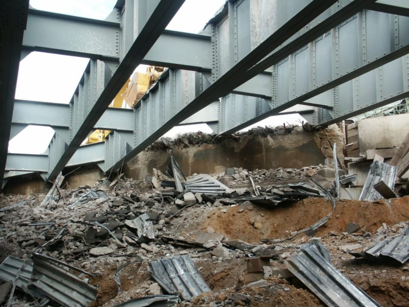

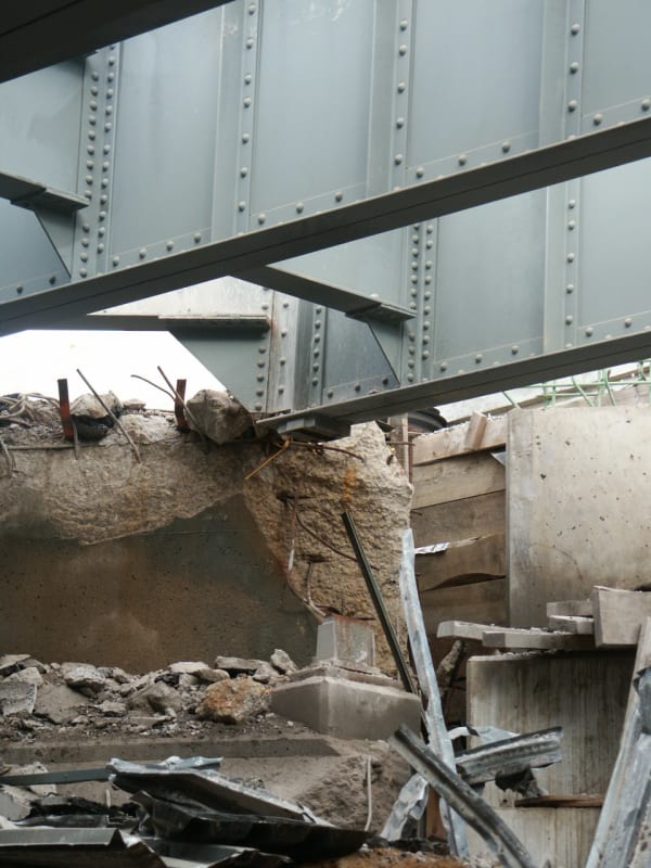

The attached photos show another good reason to properly sequence bridge deck construction AND demolition. The photos show how the bridge beams lifted up off their abutment bearing seats because the deck was removed in an incorrect sequence. The continuous 3 span bridge had hinged beam splices just inside the middle span. The first span lifted as the middle span (over the highway) dropped due to the weight of an excavator using a slab crab to remove deck sections.
Looks like a fairly large skew, which compounds the problem of, placing or removing a deck. Where was this PEinc?
It is just outside Philadelphia. The bridge had those now-banned pin hanger connections. As the excavator removed deck sections and moved from span 1 to span 2, it passed the hinge point and the deckless beams for the first span pivoted about the pier. The pinned ends of the first and second span beams dropped as the abutment end of the deckless beams rose up off the rocker bearings. That's when they called me.
