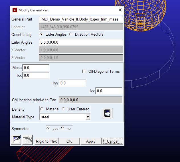

I found this in the MDI_CHASSIS.sub . So the real sprung mass part is called 'chassis', and has Ixx values. i don't know what trim_mass is for.
[PART_ASSEMBLY]
USAGE = 'chassis'
SYMMETRY = 'single'
MODE = 'rigid'
$ Rigid body data:
MASS = 663.0049
PART_LOC_X = 0.0
PART_LOC_Y = 0.0
PART_LOC_Z = 0.0
PART_ORI_ZP1 = 0.0
PART_ORI_ZP2 = 0.0
PART_ORI_ZP3 = 1.0
PART_ORI_XP1 = 1.0
PART_ORI_XP2 = 0.0
PART_ORI_XP3 = 0.0
CM_LOCATION_FROM_PART_X = 1452.643
CM_LOCATION_FROM_PART_Y = 0.0
CM_LOCATION_FROM_PART_Z = 356.0795
IXX = 2.204453E+08
IYY = 1.067216E+09
IZZ = 1.181078E+09
IXY = 0.0
IZX = 0.0
IYZ = 0.0
(COMMENTS)
{comment_line}
'Chassis Structure'
$------------------------------------------------------------------PART_ASSEMBLY
[PART_ASSEMBLY]
USAGE = 'trim_mass'
SYMMETRY = 'single'
MODE = 'rigid'
$ Rigid body data:
MASS = 0.0
$ Part location is dependent.
$ X,Y,Z location = 1452.643, 0.0, 356.0795
PART_ORI_ZP1 = 0.0
PART_ORI_ZP2 = 0.0
PART_ORI_ZP3 = 1.0
PART_ORI_XP1 = 1.0
PART_ORI_XP2 = 0.0
PART_ORI_XP3 = 0.0
CM_LOCATION_FROM_PART_X = 0.0
CM_LOCATION_FROM_PART_Z = 0.0
IXX = 0.0
IYY = 0.0
IZZ = 0.0
IXY = 0.0
IZX = 0.0
IYZ = 0.0
Cheers
Greg Locock
as you can see in the demo vehicle you can assign any inertia you like to the trim mass.
Cheers
Greg Locock

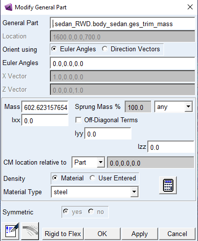

hi Greg Locock
thank you for answering in detail and taking the time for replying accurately . you have done so much since I have met this site and for that I thank you …
the last picture that you have sent is exactly what my adams/car version says except for the mass that it is 603 kilograms , ofcourse, the file that i'm using is sedan_RWD and the trim_mass belongs to that … but surprisingly 0 values for inertias just as your pic implies ostensibly …
so does that mean that it has no effect on the vehicle sprung mass ? because in the sprung mass table it is taken as 100% sprung mass and it has a 603 kilogram mass … but as I said 0 inertias just as the model above …
So , does that mean that it has no effect on the vehicle at all ??
here's a capture of the said part :
You need to wander off into database navigator and find what other masses are associated with the sprung mass, and look at those. I don't have that model. The good news is you can enter the moments of inertia directly, if you know them. A part with no MoI is just a point mass. It will affect the model.
