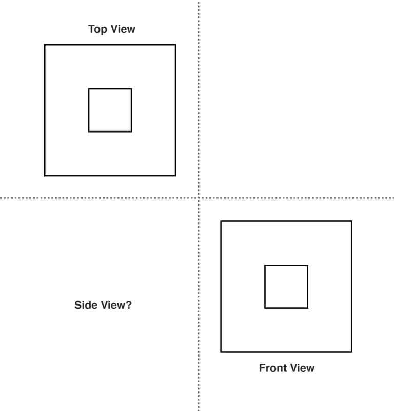

You could always ask them to finish the simple drawing below, by adding the missing Side View:

Easy
It's a thin gasket at 45 degrees with a ~1.414:1 aspect ratio. So the side view is a 45 degree line, maybe leaning left, maybe leaning right.
