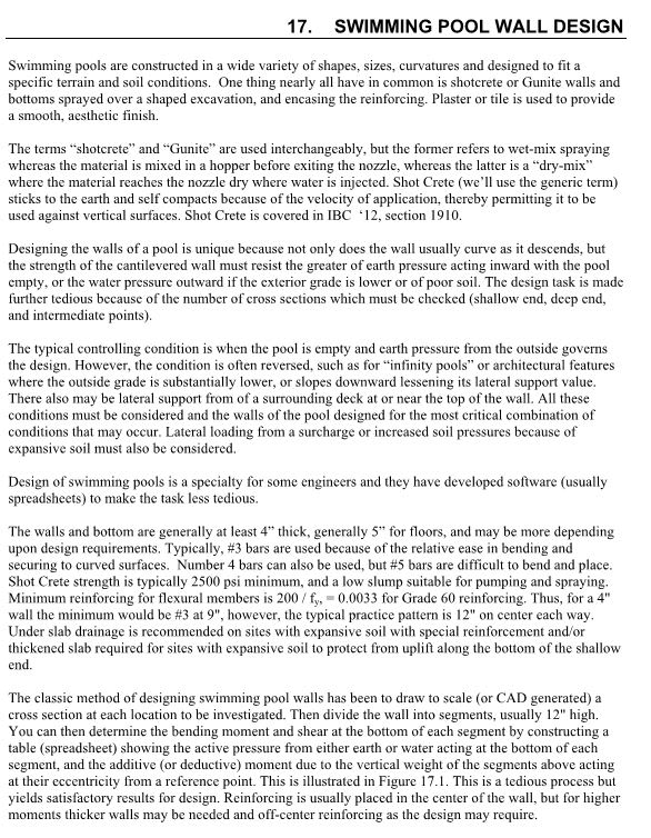

The book Basics of Retaining Wall Design has a single page on pool design.
I've always found pool design kind of intimidating owing to the seeming lack of standards and design guidance. Seems like it should be easy and something that I already know how to do but, alas, I don't. The basic boxes aren't too scary but the ones that are all curvy in cross section freak me out.
KootK -
That's a good reference. It covers all the basics of pool design. I should point out that almost never is the "curvature" of the pool considered in the design. Neither horizontal curvature or vertical.
It can be reasonably assumed that the consideration of curvature would reduce bending moments. Or, convert some of the vertical reinforcement into horizontal reinforcement. All I'm getting at it the traditional methods of analysis / design for retaining walls end up being conservative for the most part.

That minimum level of reinforcement is probably good for a 3' deep pool.... for real design you'll be limited by crack widths, limiting steel stresses and thermal effects.
Essentially follow any water retaining code as a basis.
