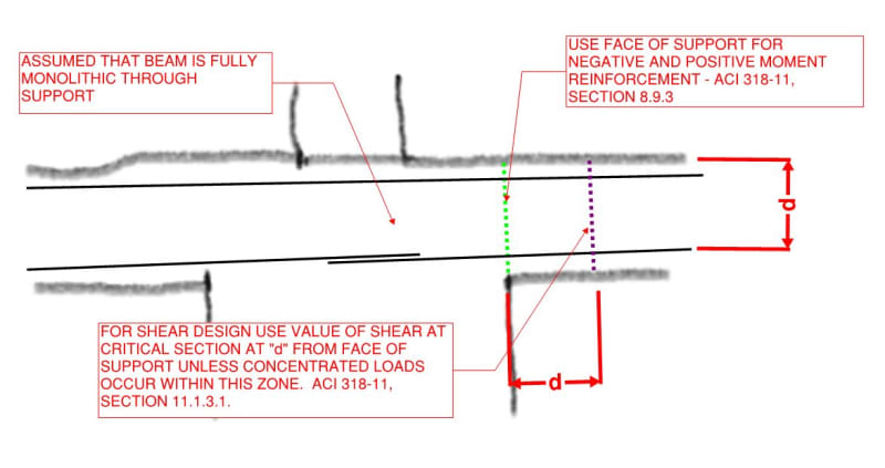

Hi, Dear All,
For concrete beam shear design, the critical section can be taken at the section which is d away from the support/column face. I am able to find this in the ACI code.
For the flexure design, more specifically for the negative moment, can we design at the face of the support or column? Is there a correponding code artical talking about the critical flexure design sections? Please advise. Thank you all so much for the help.

In ACI 318-08 it was noted in section 8.9.3 - For beams built integrally with supports, design on basis of moments at faces of support shall be permitted. (I added emphasis on built integrally)
preceding section 8.9.2 indicates for the purposes of analysis the span length is take as center to center of supports.
So as long as it is built integrally run the analysis using the full span length and for the purposes of flexural design you can use the moments at the face of supports.

Same location as moment, i.e. at the face of the support. Depending on the direction of the shear you may be able to take the critic shear an effective depth out from the support face.

JAE... you may want to reduce the length of your bottom reinforcing. It doesn't need to be so long.
Dik
@JAE,
In your diagram, I believe that 'd' should be measured from top steel to bottom of slab (which may or may not be the same as shown).

dik - I was showing the continuity steel there - otherwise you are right - per ACI only 6" into the support.
BAretired - also I think you are technically correct that d is the "applicable d" which for a typical gravity design would be the d to the top bars.
However, for moment frames, d can be either as the moment could be positive.
