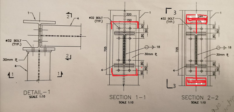

I'll sure to attach some example connection next time I'm in office. But most frame connections are in unstiffened 4 bolts end plate connection for W18x76 beam with 30mm thick plate and M24 bolts.

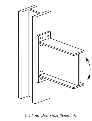

It's actually 4 bolts on the tension side. AISC considers it a fully restrained moment connection.
I should also note that this is the most common type of moment connection in the petrochem industry.... Because it doesn't involve any field welding. That's very important when the facilities you're working at have large amounts of flammable materials everywhere.

I have checked column flange for stiffening requirements. Since column flanges are very thick (=33 mm), no stiffeners are required.
I've attached below the sketch of connection.

I've already proposed to increase diameter of bolts in some connections. And now adding brackets in main frame connections where required.
I am retrofitting column splice connection by adding a plate on inside of the flange so that bolts are in double shear. I have checked this connection for Dead+Live condition and found out that half of the provided bolts are needed to resist the axial force in the connection. I've added the note in the connection to add the plate on each side of the flange in a sequence wise manner and not to open all the bolts together.
Since you have proposed to increase dia of holes, i would actually like to know if there are some necessary precautions which should be observed before and after opening the connection bolts. I searched the web for possible precautions but didn't find anything helpful.

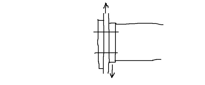

Please note connection below does not put bolts in double shear.
Retired13, I'm aware of what you are conveying about double shear and I agree its a very simple mistake some engineers are not even conscious of making. Rest assured the connection plate i'm adding will connect flanges of both column together.
Euphoria is when you learn something new.
Just want to let you know that I made the same mental mistake in the beginning too. I thought that it would be fine if the added plate was to be welded to the column flanges. Wrong, it will move with the column, so there is still only one shear plane when the beam moves in opposite direction.

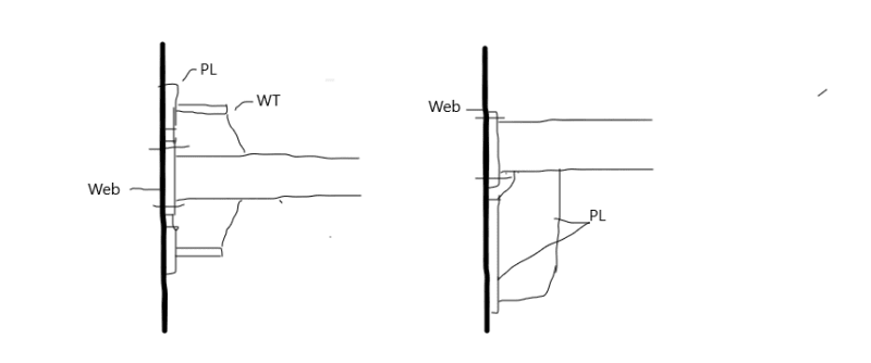

A few details for your consideration. Welding can be considered when connecting to column flange. For connecting to column web, I suggest to add bracket(s) as shown - a pair shorter bracket if there is available space to add top bracket; or a deep bracket below the beam, mainly to assist in taking care of the gravity load (shear).
