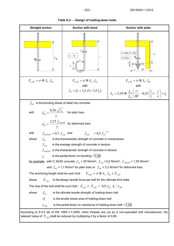

Kindly I want reference in Euro Code or BS code to check anchor embedment length and how much the concrete bond as equation from Bs code or Euro (also and more useful if its from BS code)

it's anchor bolt (base plate with threaded anchor bolt)
puh...I don't think you will find threaded anchor bolt in Eurocode
better to use finished systems like PEIKKO or similar
Eurocode EN 50341-1:2012
1 - straight anchor (fully threaded)
2 - anchor with bend
3 - anchor with plate
...but I am not sure if this thread is a typical bolt thread or thread of rebar !?!?
I personally do not know that code ( Eurocode EN 50341-1:2012 )
sorry, my mistake : deformed

but why the name of the table is holding down bolts is it different than other anchors?
...why the name of the table is holding down bolts is it different than other anchors?
I would guess it's because those requirements apply to anchors in tension, as opposed to just shear. Just a guess...
