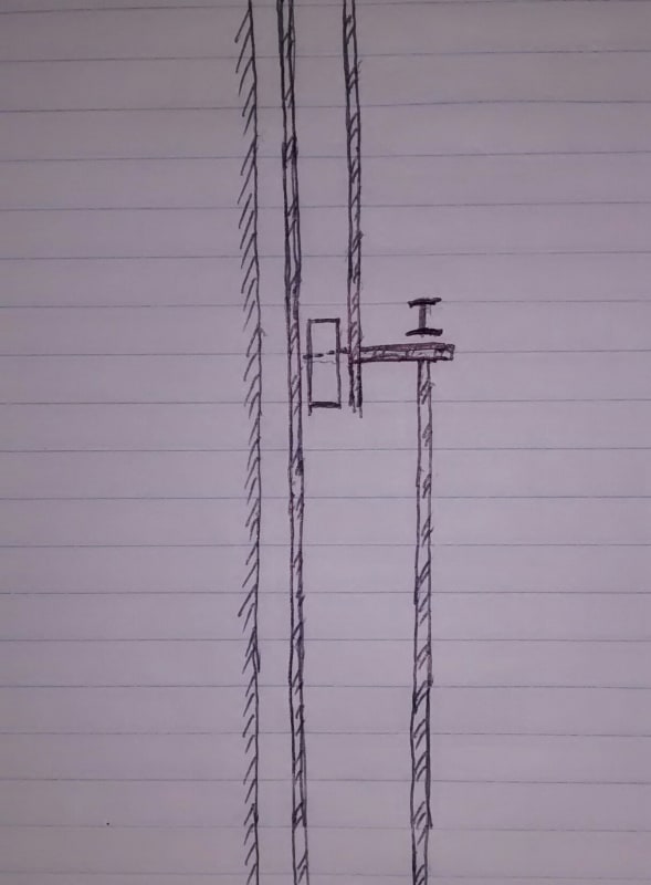

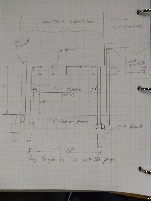

Good day,
I'm working on addition of crane in the existing shop that has 6" slab on grade floor. I will be using cast-in-place piles for crane support columns. One constraint I have is that I don't really have anything to tie into to resist lateral forces caused by crane operation (forces perpendicular to crane runway beams). The only element where I could put some forces is roof diaphragm but I don't want to put much into it.
Making column base connection as moment connection does help but involves many-many anchors. My column base plate will sit below the slab so I was thinking of relying on lateral force resistance by slab working in pair with regular column base connection to produce some moment resistance.
One concern I have is about the rigidity of this slab resistance deteriorating with time after many cycles of loading. I'm basically looking for some feedback on this idea as I'm sure many of you have considered/used this approach before.
It sounds like you are designing support system for overhead runway crane, and concerned with the lateral thrust produced by the trolley movement. Can you show a building cross section?
Please let me know if any other info is needed to better understand the situation.
Is this a new building addition? Or adding crane only? How much is the lateral thrust you got? How much space is available between the CMU wall and the column, and between the existing and new column in the middle?
It's adding crane and firewall only. Lateral thrust is 4 kip total (2 per side). I have 3" between left column and firewall and 6" between right column and existing framing.

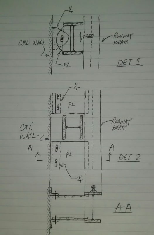

I suggest to provide CMU/concrete bond beam at the runway beam level, and provide ties that is capable of resisting the 4k lateral thrust. The tie shall consist two pieces, one on wall, and one on column. then connected by bolts through slot holes.

Retired: not sure attaching to the cmu creates any better of a load path, but if detailed properly could work.

It just to take out the lateral load, if the wall is stiff enough, instead of messing with difficult moment connection at the base, yet still produce large deflection at the runway level.
I can't quite read the vertical dimension on the left, but it looks like you may have clearance to use a rigid frame, crane columns and a beam above the crane. I would depend neither on the slab or the masonry to provide support laterally.
Ideally, it should have a backup truss, but then the wall needs to move farther away, as for now, there is only 3" space between the column and the wall. The wall needs to be reinforced both ways in order to be effective. For 5 ton crane, 4 kips lateral seem a little too high though.
I think the dimension to the roof is 20.5', and wall height approx. 22'.

Thank you for all your input. I was trying to avoid connecting to firewall as it needs break-away connections. Also, there is office mezzanine/2nd floor on the other side of the wall and putting the lateral force in the wall might result in vibrations reaching the office structure. I will check what it would take to be able to use slab on grade to provide base moment resistance.

hokie's idea of a rigid portal frame seems viable to me.
What is the lateral force resisting system for the bridge crane in the existing bay? Could you tie the new framing into the old framing to piggyback on the existing LFRS? Maybe lattice the columns together. In conjunction with a portal frame, that could stiffen everything up considerably and reduce sway.
I agree with Hokie66, the moment at base and anchor loads can be too much plus you will have stiffness problem in the frame. A rigid moment connection, either by beam-col joint or better a brace between a beam above the crane and col would be efficient and more stiff for lateral loads and sway.

1) I see some suggestions ref tying columns back to CMU wall.. we will NOT do this.. These tie backs experience dynamic & reversing loads... will cause cracks in CMU.

But still DO not tie back to CMU wall
unless its a CMU double block column WITH rebar & full pour
4) Many commercial CMU wall buildings Ive seen have a double block & poured column on regular intervals along length of wall

I don't know the distance between the short and long col on the right side of your sketch, bigger better, if they are aligned, you could tie them together with beams as moment connection and/or cross braces to resist lateral load from both cranes. Base anchors will have less tension due to wider foot print of two cols. Just a concept not sure about numbers.
