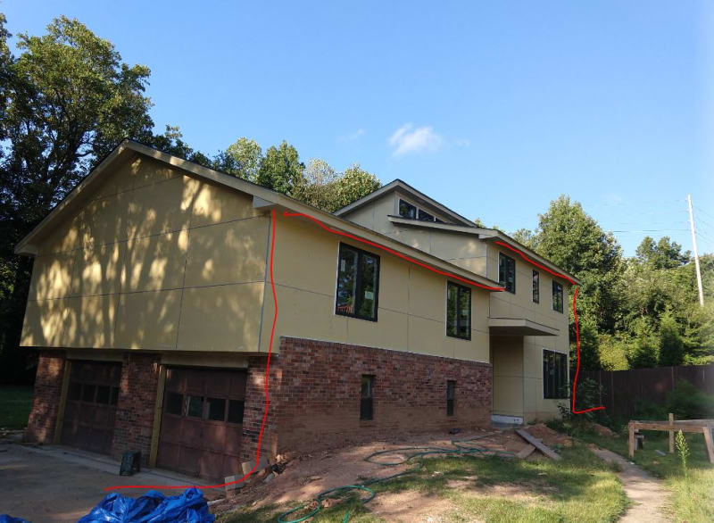

We brought a house and noticed water going into garage. It was at the top of the brick wall so that's been addressed. Our house is in Georgia so you have red clay.
The brick wall on the inside is our garage. Water is going into the ground where the red lines are at and draining into garage on the opposite side at the bottom.
1. We did install new gutters
2. Grading is sloped away from the house
3. The red lines represent a new french drain I put in 6 months ago that was working and doesn't work anymore. It was constructed with solid pvc with holes at the bottom. Cover with wrap and back filled with 57 gravel. Then dirt back-fill over top and graded away from house.
4. That wall is made up of cmu and its from 1980 so i'm sure it absorbs water.
5. When it rains heavy, it leaks water into garage and there's red dirt with the water so I assume the clay has already clogged the drain.
6. If I open the cleanout, I'm able to see daylight at the other end of the whole 30 feet pipe so I assume clay has cover all the holes and preventing water from coming in to drain properly.
After researching, I'm debating a few options and would like some professional opinion.
1. Least favorite and costly option: dig everything back up and toss the gravel. Waterproof concrete block wall, dimple board, drain pvc pipe, backfill with concrete sand based on my research on here.
2. Dig and create a swale slopping to the left and drain to backyard driveway. So this means a small mound trench, cover with sand and possibly stones for decorations. Plant and landscape on both sides.
The issue is I'm not sure how wide to go and how it would affect curb appeal.
3. Last option is to dig maybe 12 in trench, lay pvc pipe with holes on bottom, backfill with sand. Cover with some dirt and landscape normally.
4. Non-engineer solution and hacky option: Find a below grade plastic membrane, dig up 6-12 inches of all the dirt, lay this whole membrane across and span the whole wall on the ground, slope it away from house. Backfill with dirt and landscape.
4th option
install a catch basin, connect it to the existing pipe and grade to drain into the catch basin
also, not sure how water is getting into the garage, there must be some gaps or cracks in the CMU where it can run through, maybe running behind the brick. is there flashing on top of the brick?

1. we fix the brick with flashing on top, double caulk inside and outside, then paint the flashing.

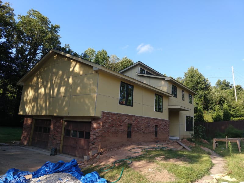

Better side picture attached. It is a pretty level and large lot so none affected by neighbors.
That ground spot where the brick is all sloped away from the house. I still don't understand how water is going down and coming into garage.
The fact that it comes into the garage AT THE BOTTOM of the CMU wall is the weird part. Because from the top grade where brick is 4 feet to the bottom of the garage.
Water is hitting the ground, draining, 3-4 feet and seep into the garage. It kinda baffle me.
I also want to mention the house was doing this prior to any renovation we did so we knew about the issue.

I looked at your second photo and it appears as though the drain pipe discharge is above the level of your garage floor. This would mean that you have ponded water in the gravel pack above your garage floor level pushing against the bricks.
Sorry, that was old pipe. We took it out. It's solid 4 in pvc pipe in the ground with holes right at the bottom of the garage floor or cmu wall.
It discharge out to the driveway.
