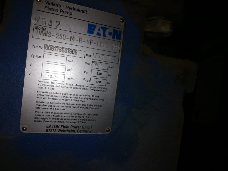

Can you please post the Vickers pump model and spec codes from the ID plate.

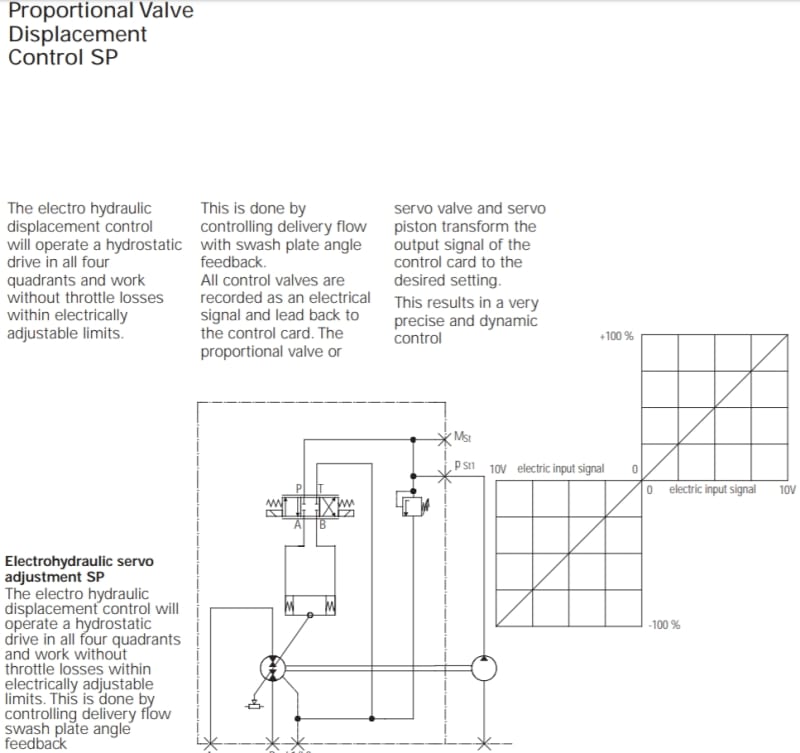

With a system built as you describe it, the swash actuating cylinders integrate the effect of the proportional valve. For as long as the valve has enough current to lift it out of its deadband, the pump will keep going further and further onto stroke. To get it off stroke again, you have to operate the valve in the other direction. This is consistent with the behaviour you're getting.
To get proportional control of the pump, it's normal to take a swash angle feedback signal from the pump and to combine that in a servo amplifier to provide closed-loop control. If you have an arrangement like that, a failure of the feedback sensor is a good way of driving the pump hard over (without affecting the operation of the manual overrides).

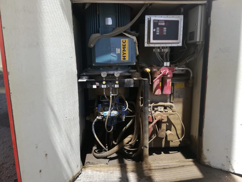

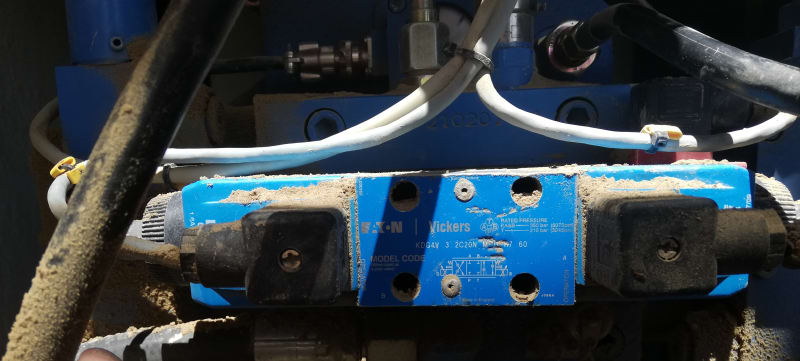

I attached some photos ( whole hydraulic station, pump nameplate, prop valve)and pump user manual.

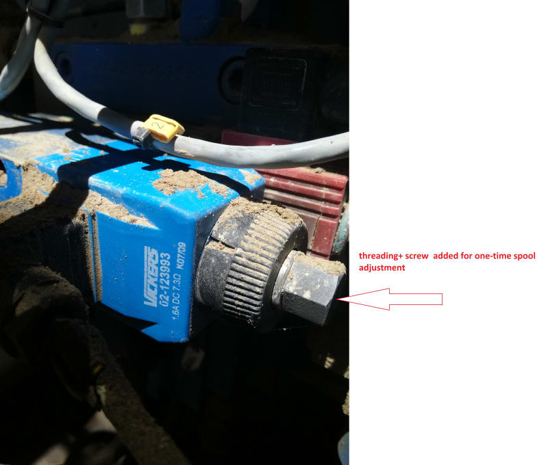

1. I removed the 02 coils out from the valve body(still wired to the amplifier who constantly checks for the presence of the coils and triggers a fault otherwise).
2. I fitted the valve body with a threading and an adjustment screw on coil "A" side to provide a fixed one-time spool adjustment in contrast to original manual pushing mecanism ( where the spool spring return requires the operator to stay at the pump the whole time).
3. My question now: I was told that there a mecanical limiting way ( like a limit switch) inside the pump to limit the swash plate internal driving piston in either direction. Would you please show me - on the user manual and/or photos- how to do it?
Unclear what this control valve has for control ability since it is impossible to read the ID number

It's unlikely that the Rexroth card will be able to provide the correct control function to the Eaton proportional directional valve. You really need the Eaton ER 9.3 card which closes the swashplate position loop via the yoke angle sensor. Maximum displacement is normally set by spacers in the control piston.
