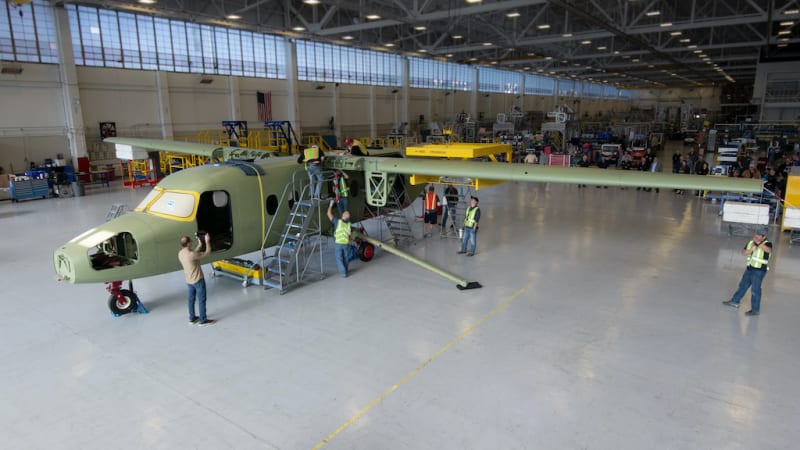

Cessna is moving along at a respectable pace. Wings have been mated to the body of the prototype. While there's still a lot of assembly yet to go, it really looks like an airplane now. It also looks "Cessna" if you notice details like the baggage doors on the nose.
The landing gear cross-beam will need a big fairing.
It's clearly an all-metal structure. The rear door is absolutely enormous. Interestingly, there are two door cut-outs side-by-side on the right. Neither looks like a convenient entrance door. I would only expect 1 of each on either side. Might have to check on the number of passengers, and any recent changes to the arrangement of emergency exits required for >19 pax in Part 23 reg's. My assumptions may be based on seeing too many Twin Otters, of 1960's vintage. I wonder if the big cargo door can or cannot be used for emergency egress of passengers?

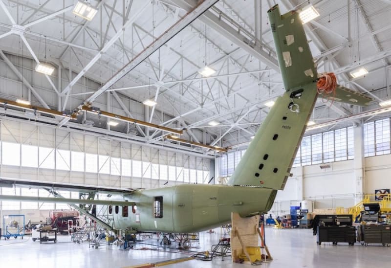

They have progressed to tail installation, not sure the trestle under the tail looks suitably robust.
RE: Cessna Skycourrier
looks like they have a type III (II?) emergency exit built into the cargo door ? and another under the wing.
an dno drag angle at the base of the V.Stab ...

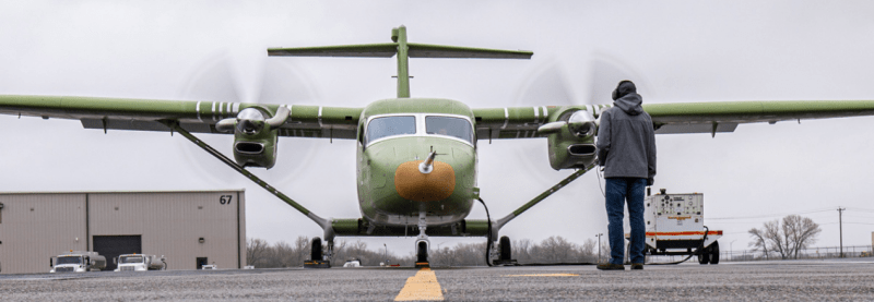

It will be interesting to what variation there is in the PT-6 exhaust angles when they get to TC. The flow angle is pretty sensitive to the power setting.
It would appear the props do not counter-rotate.
So the exhaust stacks on the left side of both left and right engines are both turned upward.
Will they be forever be getting filled with rainwater and bird droppings?
