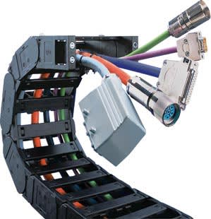

Not sure exactly what your application is but you might consider an e-chain to control your cable motion like these from Igus: [URL unfurl="true"]https://www.igus.com/info/energychains[/url]
