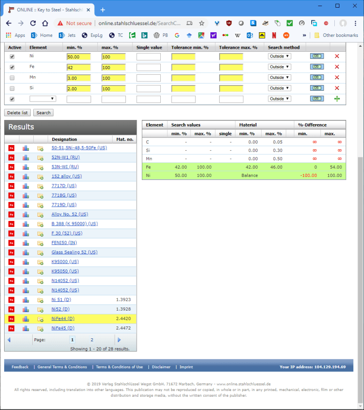

Searches for commercial materials with similar chemistry so far only come up with far fetched options. Powdered metal recipes, and parts with magnetic requirements.

My first thought is we REALLY need to do a few more tests on freshly ground surfaces.
My second thought is the test surface was contaminated with Nickel, possible anti-seize compound from previous installation, or from the wire brush used for cleaning.
My third thought is such an exotic material may have been an (expensive) foundry mistake.
