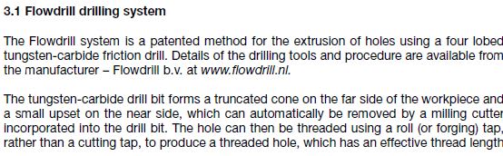

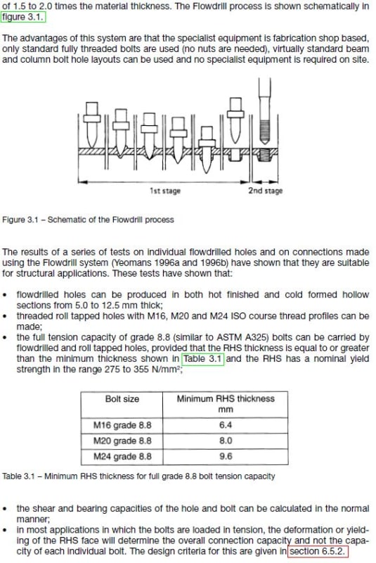

However, there has been some research and qualification for tapped HSS utilizing a process called flowdrilling. The difference being that by flowdrilling, the material that was in the hole is displaced to create a localized thicker section of wall that is then tapped. Assuming your tapped plate is plenty thick though, I imagine it would be comparable without the flowdrilling part that is required for thin-walled HSS. Cidect Design guide 9 covers this to some extent, see exerpt below:
