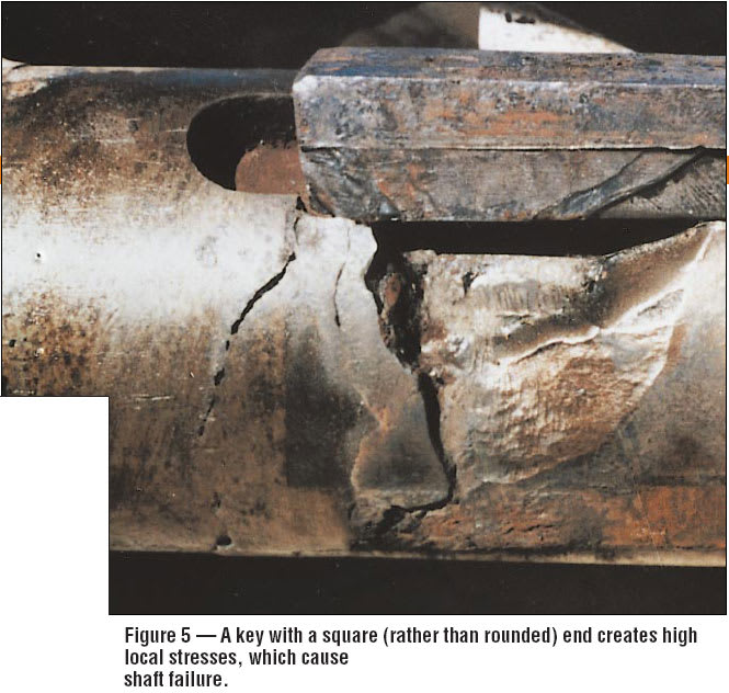

My improvement in this reverse-engineering project would be to eliminate keys and keyways and use shaft locking devices, such as Ringfeder. The rounded key looks to me like a response to a fatigue issue - there is merit in rounding the ends of keys. Don't remember who to credit for the photo.

We had a liquid ring vacuum pump that experienced two shaft fractures. We redesigned the shaft and changed to round bottom keys to reduce stress concentration. We considered eliminating the keys and using polygon fits. This could be a similar design basis.

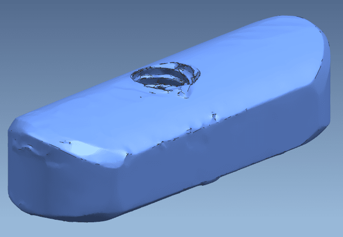

Here the scan that was made:
It looks like it has a threaded hole as well. Interesting part - but never seen one like it.
Makes me wonder how the matching slot was made. Plunge EDM seems the most likely, though powder-metal molding could also do this.
Mannes Karsten: How is this key used? Does it transmit torque? The only other reason I could see for the top rounded surface would be if it were supposed to blend in with the surrounding surfaces of the part to which it is attached. if that is the case, then it might be a replaceable wear item. So, back to my original question - what is it's purpose? What does it do?

To answer 3DDave's question of how to make a key like that, You mount the key in a keyway on a short piece of shaft and turn it on a lathe. That's another reason for the threaded hole in the key. Again, rounding the top surface of the key allows less metal to be removed from the hub in a location where the effect on hub strength is largest, and it has little effect on the shear strength of the key. Making the keyway in the hub is no different except that a non-standard broach is required. That would make sure that the OEM will most likely get the replacement part business.
I know how they make the key. How do they make the matching groove? If the groove was continuous by a broach there's no need for the extraction screw thread - that's needed when the groove has stopped ends.

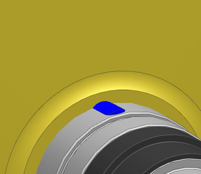

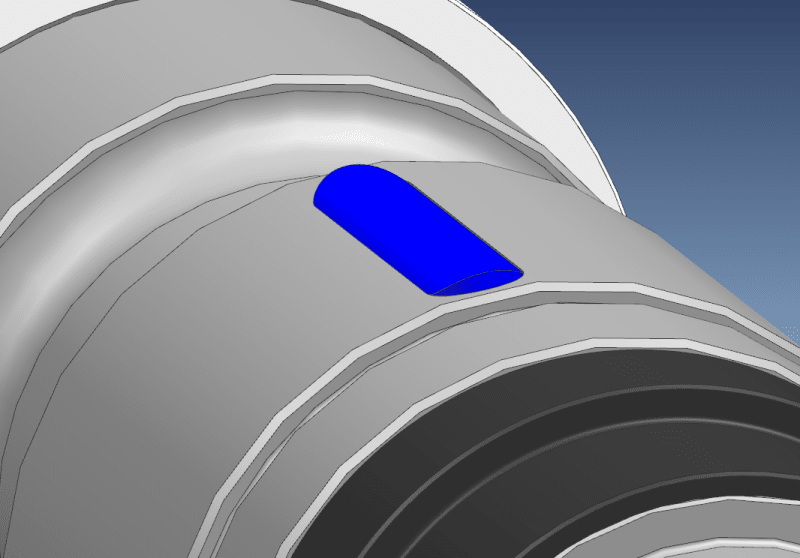

Here is how it sits in the shaft:
Here is how the impeller looks on top of it: (note that impeller is modelled in a pre-balancing state, so bore isn't accurate)
