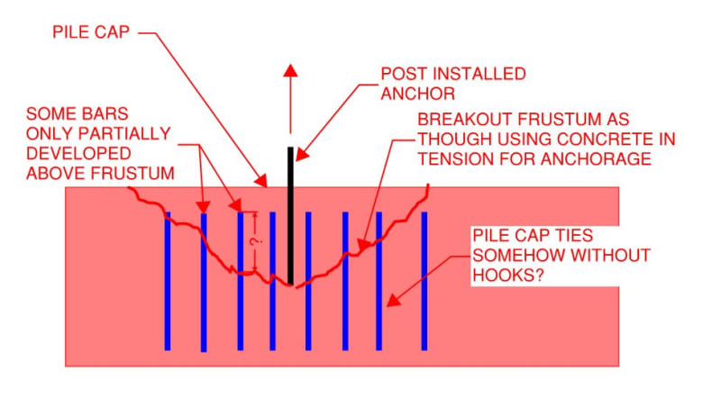

Is this what we're doing? If so, my thoughts would be as follows:
1) You can calculate capacity based on the concrete tensile/breakout capacity and, if your code allows it, take a bump for "supplementary reinforcement". Usually something minor to the tune of 15%. This is not really RC concrete design but, rather, "anchorage" in the modern concrete design sense.
2) Using strut and tie methodology, or a simplified version of it, you can use the vertical ties for your tension capacity and utilize partial bar development/anchorage where that is what you have available to you. This is really RC concrete design. You will be sacrificing some connection ductility with this route so be aware of that if ductility is important to your situation.
3) In my opinion, you cannot combine #1 & #2. Mobilizing the rebar per #2 requires already having developed the cracks that are implied by #1. So it's an "either or" case rather than a "both together" case.
Thank you for the informative image KootK.
This is exactly the image I was going to attach. The one exception is the post-installed anchor's frustrum originates higher on the post-installed (black) anchor if one is back-calculating the Hilti HVU data. From this data, one could conceptualize the cone originating as high as 49% up the post-installed anchor. The grey lines in the attached (hi-jacked) image are relevant. I can agree with those who say this is counter intuitive, but the Hilti HVU capsule numbers back it up.
I tend to agree with all of your statements; especially #3. It should be one mechanism's job, and not both. Cracking would tend to mobilize the reinforcing steel tension resistance.
In the project I'm working on, the solution is based purely on #1 without considering supplementary reinforcement. Therefore, in-line with your #3 recommendation.
You're most welcome. I'm glad that I guessed close.
pbc825 said:
...hi-jacked...
Extra utility for my sketch... all the better.
pbc825 said:
I can agree with those who say this is counter intuitive...
I do find that conclusion intuitive actually. I've always wondered how one can guarantee that any number of the infinite numbers of [breakout frustum + bond failures] don't occur in these situations. In regular bar anchorage, I belive that it's customary to assume that you loose a little wedge of concrete where the bar first enters the concrete substrate. That strikes me as similar. I've reconciled myself to the notion that, in our sphere, test results often have to trump esoteric theoretical concerns in order to keep thing moving forward.

I believe KootK's original diagram is fairly accurate, in that the potential failure cone begins where the resistance of the anchor begins. If the embedment is deep enough that the potential failure surface provides more capacity than the anchor itself, then the capacity is governed by the tension failure of the steel, but the size or depth of the potential failure cone in the concrete doesn't change; it just doesn't break out of the concrete.
BridgeSmith, I won't argue that I have a perfect model. I'm not expecting it to be code-adopted any time soon. I've just found it useful. Could be a different angle, and bond strength is included in the Hilti results.
I will point out the Hilti data I'm referencing is strictly related to concrete or bond failure. There are separate tables for steel strength in the Hilti literature I referenced.
PC
BridgeSmith, KootK's sketch accurately depicts the breakout cone for a headed anchor, not for an epoxy anchor. A headed anchor develops its strength through bearing at the head and therefore that is the plane where breakout must start. However an epoxy anchor develops along its entire length, so predicting the breakout isn't as simple as it's breakout failure can also include a pullout or epoxy shear failure at its end.
pbc825, for what it's worth, that is the best model I have seen someone use to come up with the breakout cone for an epoxy anchor. I would be comfortable with that.
