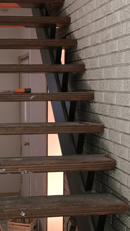

I too have built my own open rise stair, but I used mortise and tenon joinery for the treads and my span is about 1/2 of yours.
This is how I built my stringer open riser, this is one I built and removed 6 years later but it's only for 8.5' rise. There is no notching of the 10" stringer. The treads sit on riser block attached to the solid 10" x 3.5" stringers.
