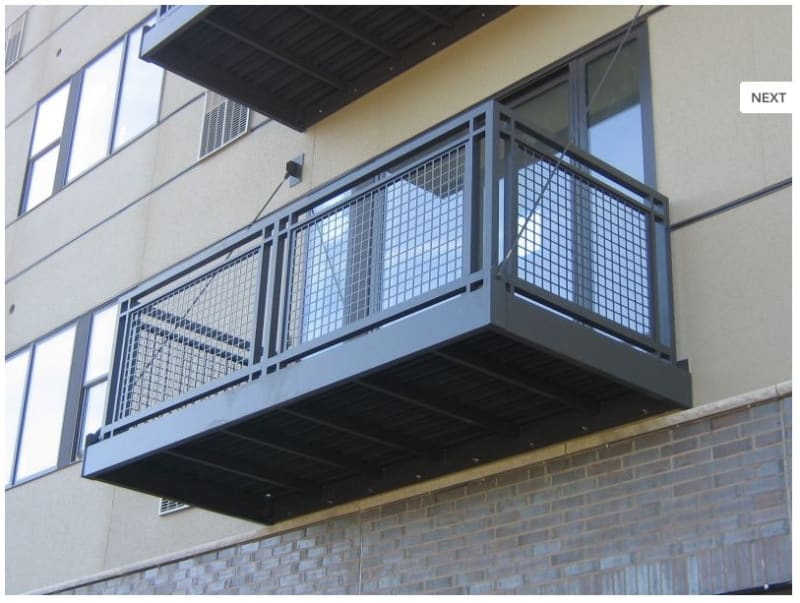

I don't have a picture of one of the decks that I have designed but it's very similar to the one below which I found online. The 5 psf dead load is conservative. The aluminum decking is 2.2 psf. The joists are less than 1 psf effective. These decks aren't overly large (approx. 5.5'x8.5') so the members aren't either.

A picture that came up shows the handrail for the balcony attached to the wall near the top rail. Is that how your competition is doing it? Looking at the handrail as some sort of Vierendeel truss that can take a compression load during uplift and then assuming the rod is only carrying tension loads? Seems somewhat plausible, though it would complicate things for the designer and the EOR to save just a little bit of steel. I guess if you're manufacturing a thousand of these things a month it might make a difference... Just a thought.
Fair enough. I guess it is aluminum, after all. I haven't done much design in aluminum for 5 or 6 years, so I forget just how light it is.
I'm not aware of them fastening the railing to the building but it's an interesting idea.
The railing keeps it from uplifting is another possibility even if you do not fasten the rail to the wall. It pushes on the wall in uplift conditions.
In the photo, is there a row of anchors at the bottom of the connection to the wall?
