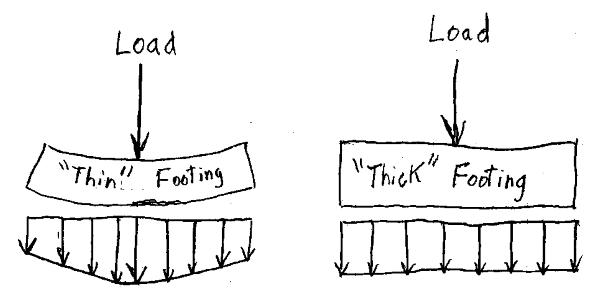

Hi guys, I have questions regarding the deflection of foundation that I hope you guys can help me.
When we design say pad footing we do load run down, load combination (DL+LL gravity in my region) and then design the footing accordingly. I don't see much consideration is given to the deflection of footing. Is it because when we design the footing we are using the allowable bearing capacity instead of ultimate one? If so, does it mean that what founding material (either clay or rock or whatever) is doesn't matter as long as the strength design works fine under allowable bearing capacity? (This doesn't sound right to me)

1) A well designed footing will have negligible deflection. To do this, the footing's moment of inertia (I) needs to be "large". Most cost effective way to get a "large" I is to make the footing thicker (relative to it's horizontal dimensions). A "thin" footing will deflect, causing non-uniform soil loading, which should be avoided. A "thick" footing (no significant deflection) provides essentially uniform soil loading over it's entire contact area. See my sketch:

In many cases, as in SRE's "thin" footing, deflections will reduce moments and shears, so it is conservative to neglect the deflection.
You can introduce a lot of extra complexity into a problem but may not gain that much accuracy in the results, either.
I seem to recall that using elastic support under a slab gives distinctly different results from assuming a semi-infinite elastic solid, for example, so you don't go from "approximate solution" to "exact", you go from "approximate solution" to "different approximate solution".
And some of the deflection is time-dependent for a further complication.

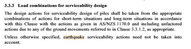

RE: Deflection of foundation.
Quote (JoanWill)
"earthquake serviceability actions need not be taken into account"
Again, I don't quite understand. Where you read this?

1) For a properly sized and designed footing (satisfies shear and bending requirements), the deflection will be very small (as expected for reinforced concrete members), and in no way affecting its performance on supporting structure above. You can verify the claim of "deflection is small" by perform a few simple calculations.

Quote (JoanWill)
Does the contractor simply stop when these target loading is reached? If so, what consideration of deflection is given here?
The contractor can't call "stop", the call is to be made by the project geotechnical engineer, who in turn, is responsible for soil exploration, and determine the target resistance. The target resistance is reached when pile shows no movement, or very little advancement within certain below count, which is calculated depending on the type of pile driving equipment in use, and the soil properties. The target resistance is much larger than the maximum design load anticipated, the safety factor is huge, as mentioned by SRE. For the point bearing pile, the potential for further settlement is close to nil, as the soil near the pile tip has already been densified by the pile driving force.
However, pile shortening can occur, but it's a time and sustained load dependent phenomenon, rarely critical in plie applications. For lateral displacement of pile head, it is limited to a limited amount during pile design stage through the evaluation of pile-soil-pile cap interaction. Lastly, the lateral deflection of pile within span, it is avoided through carefully selection of pile size (steel), and adequate reinforcing (concrete), the deflection should be very small.
Finally,
Quote (JoanWill)
why does the standard say "earthquake serviceability actions need not be taken into account" considering the piles will be driven to reach (above) the target loading caused by earthquake and no significant movement anyway? In another way, how can they consider the settling for gravity loads only when loading caused by earthquake is greater than the DL+LL?
I still couldn't make sense out of your question(s). It is quite difficult to understand the intent of a "standard" without reading the whole article. Does the standard has commentary? Which may help you to understand its intent, and applicability. Also, inputs from geotechnical engineer should be immensely helpful.
Thanks for your replies guys.
retired13,
Quote (Again, I don't quite understand. Where you read this? )
It is from the Australian piling standard. I have uploaded a pic as below. Again, as we are going to provide the loading caused by earthquake and pile will be driven until target loading is achieved and shows no movement, which means serviceability will be satisfied, so why does the code add clause like this or do I misunderstand anything here?
JoanWill,
Is "earthquake serviceability actions" explained/defined anywhere in the standard? It is the key to answer your question. At this moment, I couldn't comment, as I am not familiar with Australian codes and standards, not to mention design philosophies. But I am quite interested in your finding(s)
Coming out of left field here, is the reason it states that earthquake serviceability actions need not be considered because the building is not expected to remain serviceable in Australia after an earthquake unless it is importance level 4.
In AS1170.0 clause 2.3 there is no mention of serviceability loads to AS1170.4 unless designing in NZ
