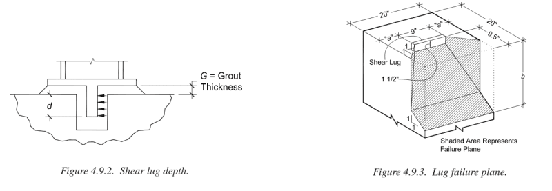

Thanks all for your comments, as i mentioned the studs provides much less shear strength, there is a solved example (4.8) in the AISIC Design Guide 01 - Column Base Plates and Anchor Design_2nd Ed, where shear lugs are used on its own to resist the whole shear force with a defined breakout failure plan which is perpendicular to the nearest edge, the check is based on ACI 349, i thought i can use the same principle to optimize my design, the only difference would be that the force is parallel to the edge not perpendicular.
See below extract from the design guide:
I understand all your concerns and i personally would prefer the studs since the calculation is more defined in the code, however in this case the design is very tight and no matter number of studs we add into, the breakout checks wont work with a limited space.

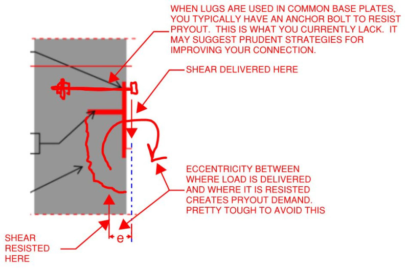

@Kootk, I dont see how pryout failure would form at the shear lug face, the only breakout that would make sense is the shear edge breakout and the concrete capacity for the bearing stress, any thoughts??
1) I stand by my pryout concern per the sketch below.
2) Why is it that you cannot use a long-ish plate with a zillion studs? Whether you use the lug or nelson studs, your ultimate resistance mechanism is the concrete. And, in my experience, it doesn't take all that many studs before you've fully mobilized the concrete with that solution to just as great an extent as you would with the lug.

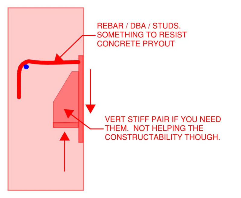

I still do not favor this connection typology over studs but, if I were forced to do something like this, here's how I'd adjust it up to address the pryout issues.
Note that this is to effectively construct jayrod's corbel but to put it inside the formwork. While I very much like the concept of using a true, external corbel, if you're already enthralled to your contractor, I'm sure that they'll veto such a thing because of the formwork costs.
KootK's sketch bring out another monster - shear friction.
The reaction developed under the stem tends to chip the concrete away in a manner similar to beam seat with concentrate load on notched concrete wall. Shear friction capacity of the concrete is to be evaluated, and more often than not, special reinforcement is required to resist the force that causing shear, and to prevent the failure of concrete in un-predicable and brittle manners. Note that the critical shear plane is usually steeper than 45°, measured from column face.
