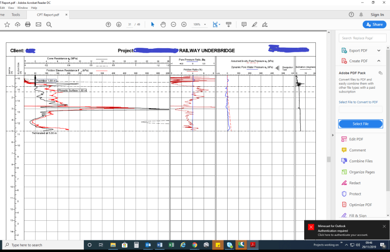

Provide us with your qc profile through the embankment.

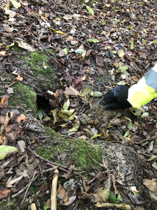

Burrowing could be rabbits. numerous holes in embankmenet wings. Everything was fairly dry. didnt see any seepage from the embankmenet.
CPTs indicate Rel density to drop to about 30% 2-3m bgl. phi' values also droop from 50 to about 35.
I'd imagine that if animal burrows were behind it all you would have intersected voids with your probes.

You might want to check for a leaking water main or poor drainage that causes localized infiltration. The "rabbit hole" looks as if water has run out of it at some time.

What is the tip resistance in your 6N fill and weld clay? Post a pic of your qc profile. Where is groundwater too.
As for animal burrows, I dont think they are the issue but if you need to disprove, you can check these by doing a MASW survey. Would also give you an idea of the various of Vs through the embankment.
