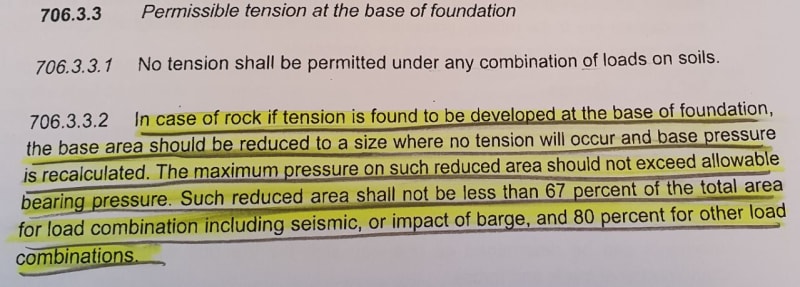

Hi all..thanks all for your valuable replies..Yes I understand that when there is negative pressure (or to re-phrase P/A-M/Z is negative) there is re-distribution of soil pressure since the bearing area will be reduced.
My question was if the overturning FOS >2 and the maximum bearing pressure < SBC, is there any limit on the reduction in bearing area as per American codes?
I was asking about the dimension marked in the below figure.
I can find a reference in Indian code (code for bridges IRC:78-2014) which is as given below:

I haven't done a tower crane foundation for a few years, but I am not aware of any such restriction in American codes.
just call me Lo.
I am not aware of any restrictions that force you to keep the resultant load within the Kern when designing a foundation for a bridge crane. Foundations for such things as dams and spillways should have enough mass to keep the load within the Kern.
DaveAtkins
My first ever assignment at my first job was to size a spread tower crane foundation. My boss had 15+ years working with them, but wanted me to struggle with it. Even gave me 3 days to work on it. From my Geotech classes at college, you learn that you need to keep the resultant force in the kern. Turns out (as DaveAtkins and Lomarandil noted) that there is no such restriction on a TC foundation. I kept coming up with plan dimensions of 35' x 35' (give or take), while he was looking for plan sizes under 30'. He gave me a book called "Cranes and Derricks" (I can't remember the author) which covers all things cranes and derricks, including their foundations. The big concern is always the wind blowing on the diagonal of your square footing. Thankfully it included a method for calculating the pressure for that scenario.
At any rate, it is common practice to allow the footing to lift off the soil under wind loads.
