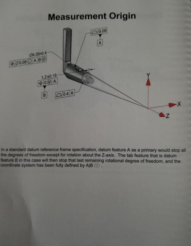

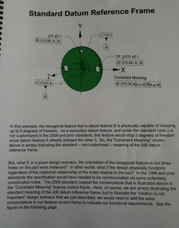

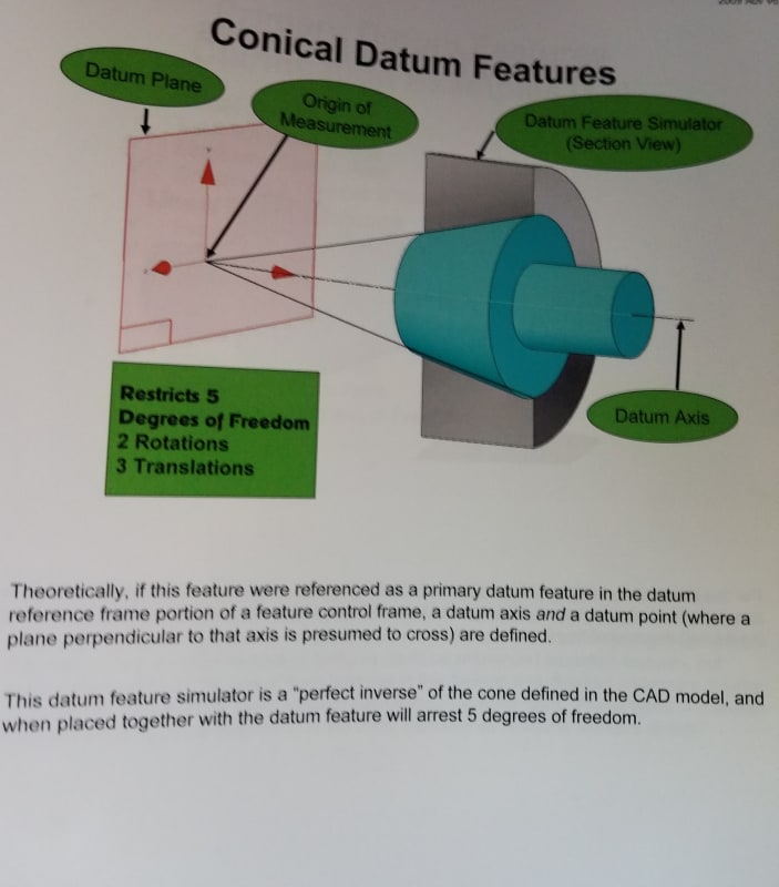

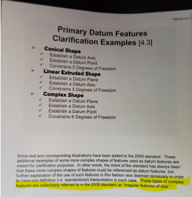

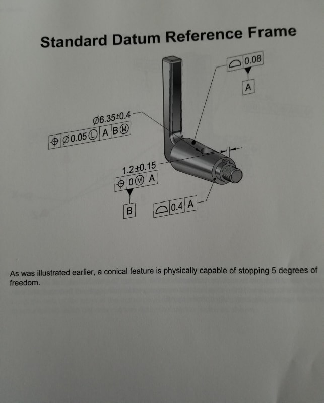

FYI:
Take it from the Pros... Conical features are FOSs (Found images from course I took years back.. AGI)
dtmbiz, very interesting figures!
Does this training material have any examples of position or orientation tolerances applied to conical or flat-tapered features?
Excellent - now show how variations in the size of the cone relate to allowable movement. Preferably without including changes in the cone angle which would also create a variation; What exactly would be the single distinguishing "size" value for a cone?
Also, that's really taking it from a single "pro". Does not seem to be the consensus, which would suggest that it is not derivable from the standard. Not much of a standard if the interpretation isn't.

The material comes from AGI Applied Geometrics Inc. "Advanced GDT Training" course book.
I took the training almost 10 years ago presented by Norman D. Crawford (GDTP S-0386). Also worked with him in a professional engineering environment.
It was my pleasure to be "mentored" by Norm during that time. I believe he has left AGI and has his own company in Cleveland Tennessee.
Mark Foster is AGI President and was the "1st ever" (GDTP S-0114) to pass the ASME administered professional exam.
Mark participates regularly in ASME Y14.5 committee meetings.
AGI and Norm's company are top rate and would highly recommend getting AGI's training. Google them.
I am not a solicitor for them and its been years since I have any contact with AGI or Norm
Burunduk, the below chart is in ASME 14.5 2009. If you can do a conical feature of size, it seems the same principles would apply
to "inclined" (tapered for conical) opposed surfaces equally disposed about a center plane.

Please detail the answer of how to determine the unambiguous size.
Also note that the trainers don't seem to have done so.

Paragraph 4.11.4 (a) which was quoted, and also (b) and (c) convey that specifically for cylindrical, width-type, and spherical primary datum features it is true that "datum feature simulator" = "UAME".
None of these shapes is a cone or a flat taper.
While it may seem somewhat natural that the rule for cylinders can be extended to other surfaces of revolution, I would be cautious to do so, because the language of the standard is very specific in this case, and besides there are important geometrical differences: apart from the somewhat ambiguous meaning of "...smallest circumscribed (for an external feature) or largest inscribed (for an internal feature).." where there is no single size value to be smallest/largest, a conical datum feature simulator can be non-adjustable, and will still act the same as collet-like device with a conical opening to contain the feature, as long as the included angle is correct and the simulator covers the entire diametrical range of the considered feature (if it is a theoretical simulator, and Y14.5 talks mainly of these, there is no reason why it won't). That is while para. 4.5.2 imposes a requirement on a datum feature simulator: "(f) adjustable in size, when the datum feature applies at RMB." All this seems problematic.

Yes the cylinder reference to compare the Datum Feature Simulator and an AME as the same, is one that
directly connects the FOS and AME standard's "intent" for the subject. I believe it is reasonable logic to believe is true for all FOS’s.
Size limits are required to be verified first before an AME is defined or any attempt at validating geometric controls is made.
The expansion/contraction of a similar perfect (gage tolerances) counterpart contacts the produced feature's "high points" to define
a "mating size" per se (Actual Mating Envelope) for a produced feature. Not multiple variations of size through out the feature's surface imperfections.
The "envelope size" is used relative to how the feature mates (assembles) to its corresponding mating feature.
