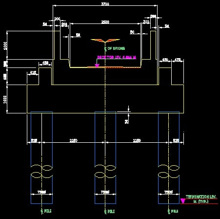

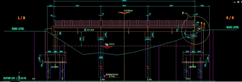

Dear All,
I am designing a 8.02 meter clear span R.C.C. slab bridge with 2.5 m clear carriageway. I am providing there 3 no. 750 mm diameter pile as pier. The pier will be continued so that it acts also as pile foundation. No separate pile cap is being provided in this case or the pile cum pier are directly extending from the pier cap which is a 1.1 m x 1.0 m x 5.5 m R.C.C. beam. In this connection if someone explain me how to design the pier as per SP 16 it will be helpful to me.
With Regards,
Ujwal Mandal
To be sure I'm understanding the configuration, you'll have a cast-in-place (CIP) concrete cap supported by 3 CIP concrete columns, which are each supported by a CIP concrete shaft poured in a drilled (augered) hole in the ground. Is this correct?
My reading was that the piles have dual functions, in addition to be a foundation element, they are acted as pier/columns. There is a concrete cap on the top to support the bridge deck, but no ties/cap on the ground level. The question is how to design the pier/piles (same element) per ACI SP 16, I assume.

Sorry sir, i am new to this forum and not habituated with this. Sorry for late respond. You are right. Kindly give me suggestion.
To
retired13
Sorry sir, sorry for late reply, I am new to this forum. kindly pardon me. yes you are right. i want to design this as per Indian Standard. IS SP 16.

For the abutments, where there are 2 rows of shafts, and the cap is in soil, we would generally apply the moments as force couples producing axial bearing and uplift loads. We would assume the applied shears are resisted by the soil on the side of the cap.
For the piers (what we would call "bents", don't ask me why), we would iterate to get the depth into the soil that produces an equivalent cantilever for one of the major load cases, using structural analysis software for the frame analysis and P-y curve analysis software (Allpile or Lpile) to model the effect of the lateral soil resistance on the shaft. We find the length of a fixed-base column that has similar stiffness to the column plus the shaft embedded in soil. It's usually fairly close to the first moment reversal (inflection point) of the shaft in the soil). This allows us to process all the load cases in the structural analysis software using the same, simplified model.
Sometimes we take the simpler and conservative approach of applying the moments and shears at the groundline assuming the column fixed at that point, and apply those to the top of the shaft in Allpile or Lpile to get the maximum reactions in the shaft.
