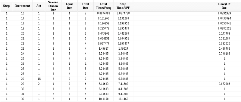

I am a bit confused About the interaction Parameter warning, since i never had it before. I post a screenshot regarding the increment size of the step. It uses an increment of size "1" and then it suddenly stops, shouldnt it usually try another iteration with a smaller increment size?

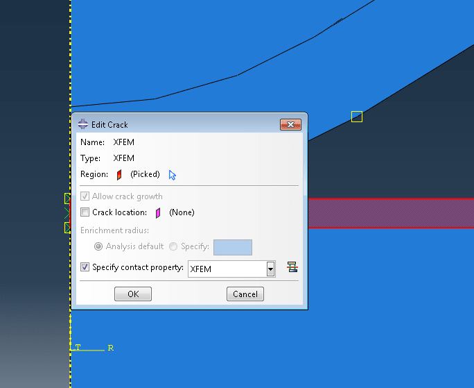

Try including this contact interaction between cracked faces as suggested by the first warning (in CAE use Edit Crack —> Specify contact property which is equivalent to *Enrichment, Interaction=... in input file). If this doesn’t help reduce initial and maximum increment size as well as increase the maximum number of increments (unless they are already correctly adjusted), use automatic stabilization in the step settings and damage stabilization in material properties. Also make sure that you checked Discontinuous analysis in solution controls. If your model is force controlled consider using displacement control instead.
The convert severe discontinuities tab is checked and i added a automatic stabilization with the Default damping factor. I am still unsure though About the Enrichment error i got, i already added a contact property to the crack if that is what you meant, and i still got the error message:

Also the error Please check to make sure that the interaction parameter is used on the *enrichment option for lefm criterion or low cycle fatigue analysis.
still occurs after implementing the contact property in the XFEM crack.
Since you don’t use LEFM-based damage criterion or LCF analysis (both require *Fracture Criterion keyword), I think that this warning is irrelevant in your case.
