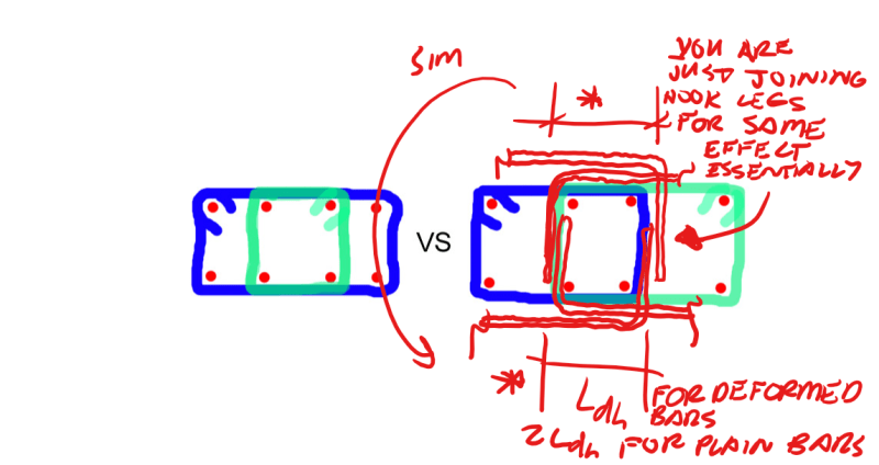

Yes your drawings contain closed stirrups, the hook (bend) around the bar going into the concrete is effectively the same as the extension on a standard hook in this scenario. The two extensions are the same bar with a closed stirrup.
The closed stirrups are fine, I'd do exactly the same. However the point is you may need the lap or overlap between the two separate closed stirrups to be sufficient to achieve a development length like the sketch I have marked up in the last post. I'm not sure how to articulate it any other way?
On the sides of the column where you have the stirrups overlapping, the overlap may need to be a code compliant lap (i.e. L_dh). This may depend on what standard you are working to, but either way it is a good detailing practice. If the bar is plain round bar, then it is usual that 2 times the standard lap for deformed bars is required.
