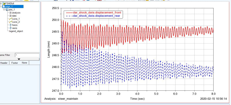

But I have another problem now, whenever I begin a simulation my front seems to vibrate. I will attach my files and a jpg showing the vibration in post processing. It seems during the start of the sim, my car is somehow 'dropped' from a certain height?
That kind of explains why it changes the damper travel for a time being and dampens slowly.
I am also enclosing all my FSAE files for your reference. If you decide to run it, please only do it with 'locked' steering. It is not running with 'straight' steering because it's an open loop somehow.
If you can point me to some place where I can get to know how does the model fit into driving system that would also tremendously help me.
PS: Really sorry if this seems stupid, I am just a student trying to learn this from internet information.
Your model is assembled at the defined geometry. Then gravity is switched on and all the compliances come into play so it does indeed drop. One way to get around this is to allow it to settle before running a maneuver, using a static funnel. In your case you appear to have an undamped resonance at 10 Hz, which makes me think wheelhop. Look at the animations carefully and see if you can see anything vibrating, or put a little bit of damping into every compliance. Sorry I'm not going to run your model I use an old customised version of ADAMS.

Problem was with the actual damper template, it was a glitch I guess. The template was from ADAMS 15, which wasn't working with the model. I swapped it with the latest one from existing templates and voila, it did the magic. So yes, it was undamped oscillations.
There is only one thing that I am not able to figure out yet. Every-time I run my model in straight line events > maintain > drift (locked steering). My model drifts to the right (video enclosed along with plot of spring travel). If I set steering to straight (machine controlled), my car turns right sharply.
