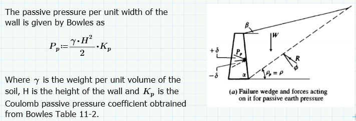

I have a need to pull something very heavy along the ground, where the calculated pull is in the order of hundreds of metric tonnes force. The pull will be done by a large winch, with a big wire, all straightforward so far. The question I have is how to anchor the winch (i.e. react the force of the pull).
It's temporary so I don't want to design a concrete foundation, the plan is to use a ground anchor to tie back to, as follows.
A sheet pile wall driven into the sandy (ish) ground and a series of anchor wires from the "wall" to the winch.
I have assumed a simple retaining wall load case and Coulomb Earth Pressure Theory but rather than the conventional "active" pressure case of the wall resisting the mass of soil behind it, I am assuming the "passive case" as if the wall were trying to push the soil back. Has anyone used this before and does it sound a reasonable approach?
I have made some assumptions for ground mass and slip angle, trying to be conservative for both, but if there happens to be a water table at the depth of the wall (likely) I can't make up my mind whether the water will act to increase the holding power of the "anchor" or act against me. Or since the water would be on both sides of the "wall" is it effectively balanced?
I have assumed a value for saturated soil.

One comment, water will reduce your effective stress which will reduce you sliding resistance, depending where its location.

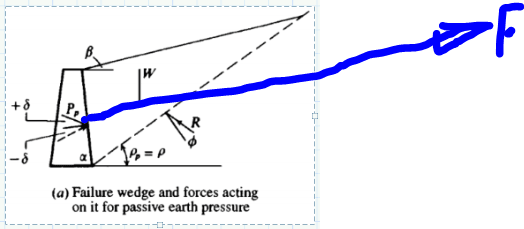

The details of the something heavy and the rest of the operation I'm comfortable with and won't be shared on a public forum for all the usual reasons. Sorry. The question I asked resolves to the geotechnical details of an anchor in earth to resist a large horizontal (or nearly horizontal) pull.
Hopefully the sketch below helps illustrate the normal retaining wall technique, although in my case the wall in the sketch will be driven into place, with earth on both sides.

This question isn't about retaining walls or conventional soil anchors (in the slope stabilisation sense). For the avoidance of doubt the force I would like to resist is in the direction indicated in the sketch below.
i.e. all the tension tie rods and piles in figure 16.13 above would be in compression.
A block anchor (deadman) may well end up being the end solution although the calculation of the size and how to treat the effect of water likely remains the same.
In your sketch, the winch is to the right of the wall. The winch cannot be buried in the ground. Therefore, depending on the geometry, there could be a reduction in the available passive resistance of the wall if you cannot develop the full passive wedge. Make sure the excavated or non-filled area where the winch is sitting will allow sufficient passive resistance with an acceptable safety factor. Also, make sure that the wall is designed so that it can retain the soil before the winch pulls on the wall. The wall needs to be stable without any assistance from the winch.
If the wall (piles, deadman, whatever) is buried in the soil and will be needing the earth to resist the applied load, then yes you will be relying on passive pressure.
The resultant of the earth pressure will be someplace between half of the element height and the lowermost 1/3rd of the element height, where height is defined as "the buried portion".
Use the Rankine formula (simpler than Coulomb) for passive pressure - Coulomb is unconservative for passive pressure as soil friction angle increases.
If you are using discrete elements (soldier piles), you will want to look at the work of Broms and Wang-Reese on the passive resistance of discrete piles.

As you can see from retired13's examples, developing several hundred tonnes of resistance takes a big structure. If the soil has high cohesion, the passive resistance of the wall per linear foot is 2*C*H +Gamma*H^2*Kp/2. C = cohesion in tonnes per square foot; 3 would be a big number. Gamma is roughly 0.06 tonnes per cubic foot. Kp could be as small as 1.0 for cohesive soil. H is the wall height in feet. If the soil is cohesionless sand, C is zero and Kp is somewhere between 3 and 5.
If the soil can be penetrated by helical anchors, you might consider a field of such anchors installed at an angle between 30 and 45 degrees from horizontal, linked up by cables to a common connection. Lay a railroad tie or two or three under each cable to take the vertical component. You may be able to rent the anchors; they can be recovered. You still need a geotech to run the calculations.
Yes, passive resistance of a sheet pile wall is a reasonable approach. You could tie your cables near the lower third point or tie the top of the wall to a second wall some distance behind the first.
Ground water will buoy up the soil and reduce the passive resistance.
