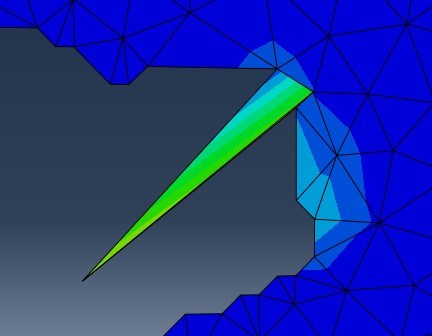

Result visual problem 1
NEROOO
Oct 23, 2019
36
matersials property:
- elastic
- plastic-combined hardening with cyclic hardening
- ductile damage
0.02
- damage evolution
0.003

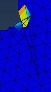

I want to simulate the fracture near the voids, however, there shows only the strange triangles, like error...
any suggestions? Looking for help, thanks!
Please provide more information about this analysis - how does the model look like (picture of the whole mesh would be very helpful), what are the boundary conditions and loads, which step type is used and so on. It would be best if you could attach your .inp or .cae file but often it’s not possible due to confidentiality so you can just describe the settings.
Was the field output variable STATUS requested? This variable allows A/CAE to hide failed elements in postprocessing.
