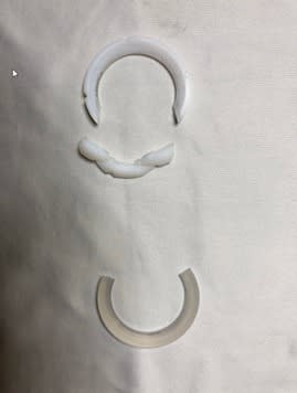

Hi everyone,
We have some ball valves (1.25" and 6" sized)in which the upstream TFM seat is being clipped by the ball and damaging the seat which sends parts of the seat downstream.
Does anyone have any idea why this must be happening?
All valve parts have been designed and manufactured as per the dimensions so it shouldn't happen.

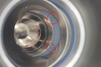

The valves are actuated and service conditions are ambient. See below photos. If it had the dimensional problem, then why it is just happening on the upstream seat of a few valves? Dimensional inaccuracy could have occurred at the downstream seat as well.
The edges of the hole in the ball must be properly chamfered, or it will act as a knife edge. Also, excessive compression of the seal will extrude material to where the excess gets cut-off by the ball hole edge when closing the valve.
It appears that seal has been "rolled". This would be caused by very high friction between the ball and the seal. Friction between plastics and metals is very highly dependent on the surface finish of the metal, and there is a "sweet spot". Too highly polished will cause high friction.
This happens in a soft-seated ball valve when the upstream seat is not strong enough. When the valve starts to crack open, the upstream pressure (and flow) is bending the unsupported section of the seat into the ball port. As the valve continues to open, it chops-off the deformed portion of the seat. Need a stronger plastic or a way to retain the seat so it cannot bend into the ball flow port.

It's difficult to see what those red circles are trying to show - I can't zoom in enough.
Are these valves being operated 15% open so those marks line up with the ball to seat location? They appear to be nicks or cuts in the ball itself?
