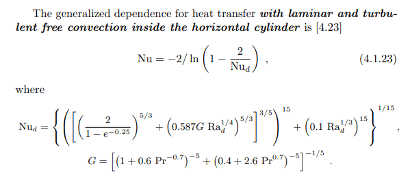

I have a transient pipe model (internal flow of water inside the pipe) that can calculate the water temperature distribution through the pipe length over time (solving convection-diffusion equation with heat sink).
This pipe model considers the heat transfer (as loss from the water to the surrounding ground) at turbulent and laminar flow conditions (using Gnielinski correlation, and Mills correlation to obtain the water thermal resistance, respectively).
My Question: How can I calculate the water thermal resistance when there is no flow condition?

I don't have this handbook. But laminar flow?
“In life, the truest guide is science” – Mustafa Kemal Atatürk
I could find a correlation for completely filled horizontal cylinder at the book chapter by Martynenko OG, Khramtsov PP. Chapter 4 - Natural convection in enclosures. In: Free-Convective Heat Transfer. Springer. pp. 279-343.
That is the closest I can find for this case. It appararently is valid for NGr as low as 0.10.
