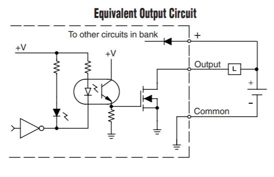

This is the DC transistor output structure of that particular PLC:
Note that the LED on the PLC is on the isolated PLC logic side NOT the 'field side' where you're seeing a problem.
Your light should not draw more than 0.5A nor have an inrush exceeding 1.5A not to exceed 10ms.
It leaks 15uA when NOT active.

Thanks for all the responses. This weekend I tried my output with a 120VAC incandescent light instead of the 24VDC I have been using and it worked just fine. So it does look like it's a voltage issue so I'm going to try and get a resistor and maybe a mechanical relay to see if it doesn't help my situation. Thank you again.
So today I relized that the PLC is an AC output and that is why it worked when I hooked up the incandecent light but it's strange because I did have it working on 24VDC output for a long time. Leason learned and I will try to keep on learning more about PLC's. Thank you all for your help it has been greatly appreceiated.

It would be a SCR/TRIAC output which latches with enough DC current. Maybe your circuit was below the holding current of the TRIAC originally. Did a change in the light bulb or type correspond with it not working?
