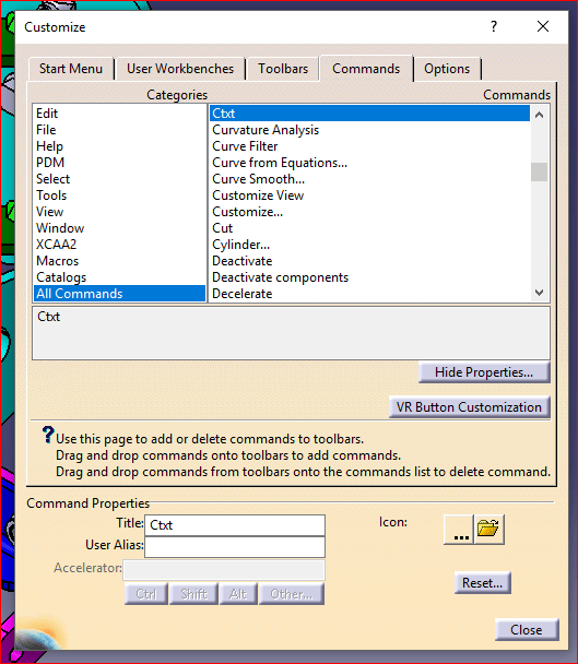

try to find the cumulative snap function...
Eric N.
Itsmyjob,
[2thumbsup]
I do not have this option......
How could I get it?

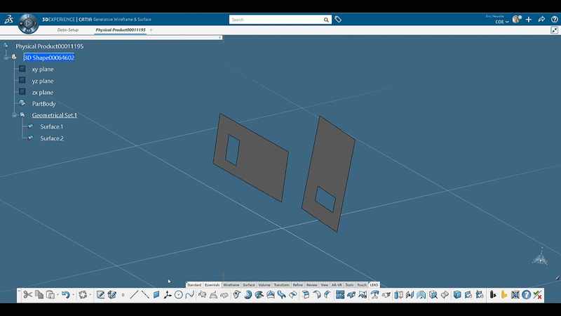

I was wondering if CATPart or GSD has a similar tool.
Able to move parts or/and surfaces......
CAD 2015
in CATPart you can use compass and axis to move isolated elements...
[ol 1]
[li]create target axis[/li]
[li]create source axis (becomes current)[/li]
[li]move compass anywhere on geometry (becomes orange)[/li]
[li]unselect geometry (compass become white)[/li]
[li]open compass parameter (from double click on compass)[/li]
[li]define reference as active object (will get current -source- axis as reference)[/li]
[li]define position 0,0,0, rotation 0,0,0[/li]
[li]verify nothing is selected (compass white)[/li]
[li]apply position[/li]
[li]compass only move to source axis[/li]
[li]define target axis as current[/li]
[li]make sure reference is picket new current target axis value[/li]
[li]select source surface (compass turn orange)[/li]
[li]define position 0,0,0 rotation 0,0,0[/li]
[li]make sure only source surface is selected[/li]
[li]apply[/li]
[li]source surface moves with compass to target axis on target surface[/li]
