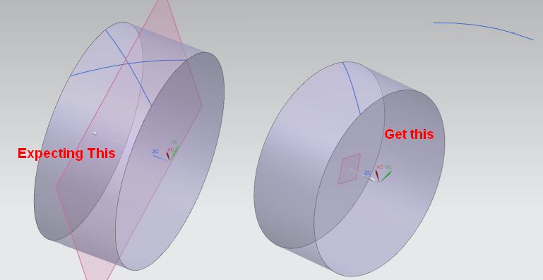

I now have a problem with a Datum Plane I created in the Attached Journal. It looks fine but when I use it to mirror the Helix I get unexpected results. Part file attached. (Had some trouble attaching 2 files, so I just copied and pasted the links)
I fixed the problem by creating the Datum with the code below. Still not sure why the other creation method produced the issue but I'm moving on.
Dim wcsMatrix As NXOpen.Matrix3x3 = workPart.WCS.CoordinateSystem.Orientation.Element
Dim myPlane As NXOpen.DatumPlane = workPart.Datums.CreateFixedDatumPlane(CenterPt, wcsMatrix)
