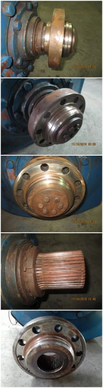

We have received a GE 1000 HP, 1200 RPM DC motor with spline coupling area on the shaft as below. The driven equipment is a 1000 KVA AC alternator.
As you can see, there are plenty of damages/misaligned grooves in the spline area of the shaft.
I am not sure how good is the contact area of the shaft with the spline coupling with so much damages.
I plan to replace this splined shaft with a new shaft having a standard keyed flange coupling like this.
Do you mech gurus see any issue with such a plan?

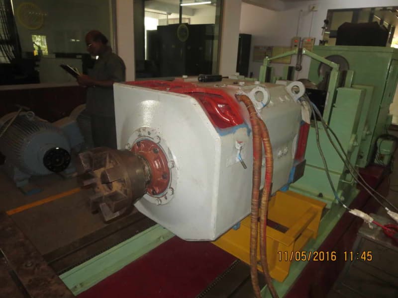

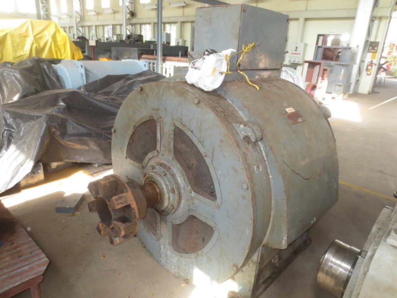

You are right about rubber plugs, both the motor and the alternator have bolted on lovejoy coupling units with rubber pads.

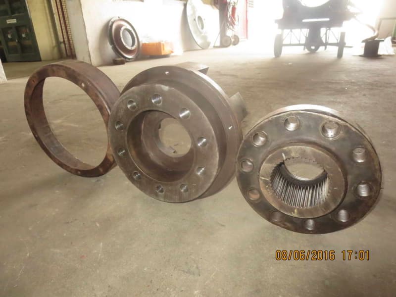

Motor coupling parts including the bolted on lovejoy unit
Motor coupling with bolted lovejoy unit and the lovejoy rubber pads
Motor fitted with the coupling
Generator with its own lovejoy coupling unit
What if I reuse the bolted lovejoy unit of the motor with a cylindrical bore flange coupling so that the original compliance is met with?

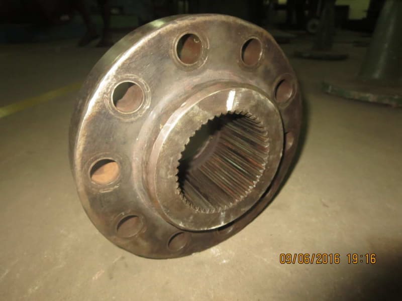

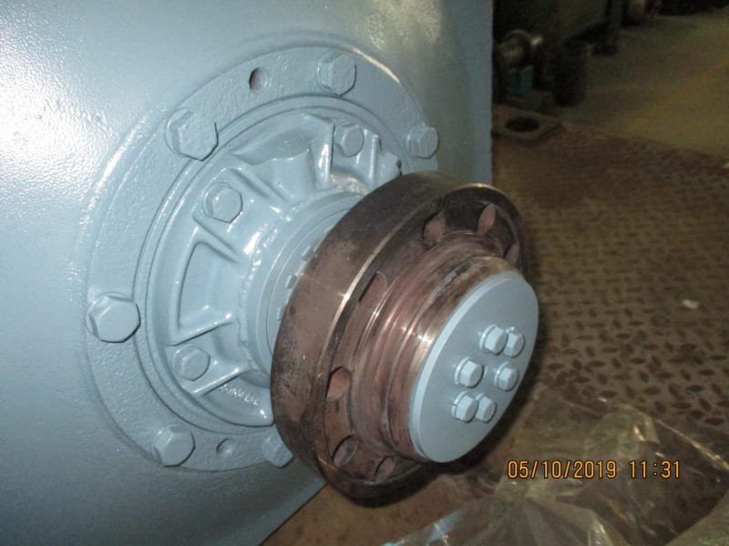

The photos of the spline coupling of the motor we received today.
After removing the front face lock plate, the whole coupling slid off the shaft by hand. At least the spline areas appear to be damage free both on the shaft and the coupling bore.
