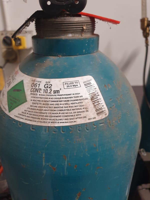

We have a compressed gas cylinder containing Argon on site at the following specifications:
Pressure = 20MPa
Volume= 10.2 m3
Temperature= 288K
I am trying to get the theoretical amount of Ar inside. I used the ideal gas law where PV=nRT but seem to be getting a result which does not look right.

10 cubic metres??
That's a decent sized pressure vessel not a gas cylinder. 100 litres maybe?
You don't list units here so it's difficult to check the calculation.

According to what is printed on the cylinder, it is 10.2m3.
Still an intern
!) When you see something strange, engage brain. A cylinder like this is clearly not 10 CUBIC METRES
That's a box 1m x 1m x 10m. Does that cylinder look that big??
The wording on the bottle, which is quite crucial, is 10.2 Sm3. That S means Standard or "atmospheric"
Hence the volume of the gas at 200 bar in that cylinder at "standard" conditions would be 10.2 m3
On a very basic p1V1=P2V2, at 200 bar that means that the volume of the gas inside the cylinder is about 0.05m3, so 50 litres.
Now density of argon gas at 300K and 1 bar a is about 1.6 kg/m3. Your bottle tells you, you have 10.2 Sm3 of the stuff so the mass of gas in the bottle is 10.2 x 1.6 = 16.32 kg
If you put 50litres into your calc you get more or less the same.
WC = 50.8 litres per your earlier post, not 10.2m3.
We know that 1kgmole of an ideal gas occupies 23.645 Sm3 (ie at 1atm, 15.6degC or 60degF). So an easier calc is (10.2 / 23. 645) x 40 = 17.2kg of Ar. This approach will account for Ar compressibility also at 20MPa.
