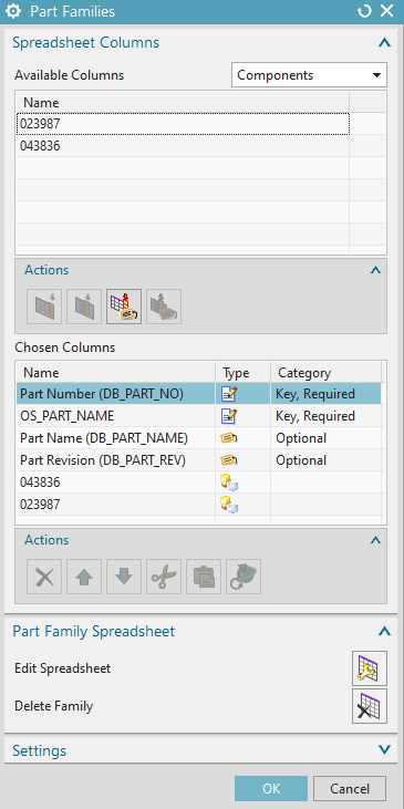

Hello,
Is there a way to control which revision of components is used in the speadsheet of an assembly part family?
I want to define the Item ID and revision, instead of only the Item ID.
For Example 023987/B & 043836/C
Thanks.
The partfamily spreadsheet is only used for the creation of the members and which components they use. It is not telling your assembly (where a member is used) which revision to take.
This functionality comes from the load options.
