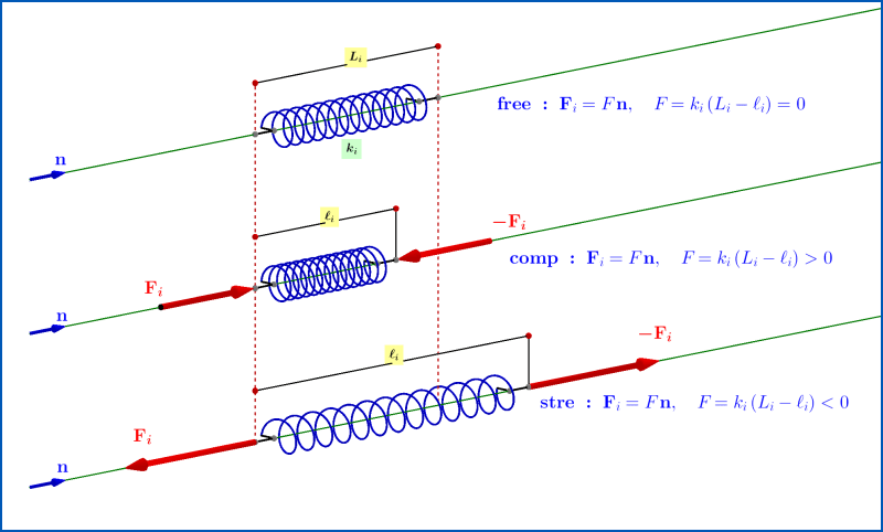

what i ment wasN'T that i need a force that acts in positive and negative direction with respect to it's reference coordinate system .
let me explain more with a picture :
I need to create such a force for the upper and lower part of my damper mounts in Adams/View … do I have to create two forces on the upper and lower hard point mount parts Individually ? or there's a command that does both in Adams ?
thank you
